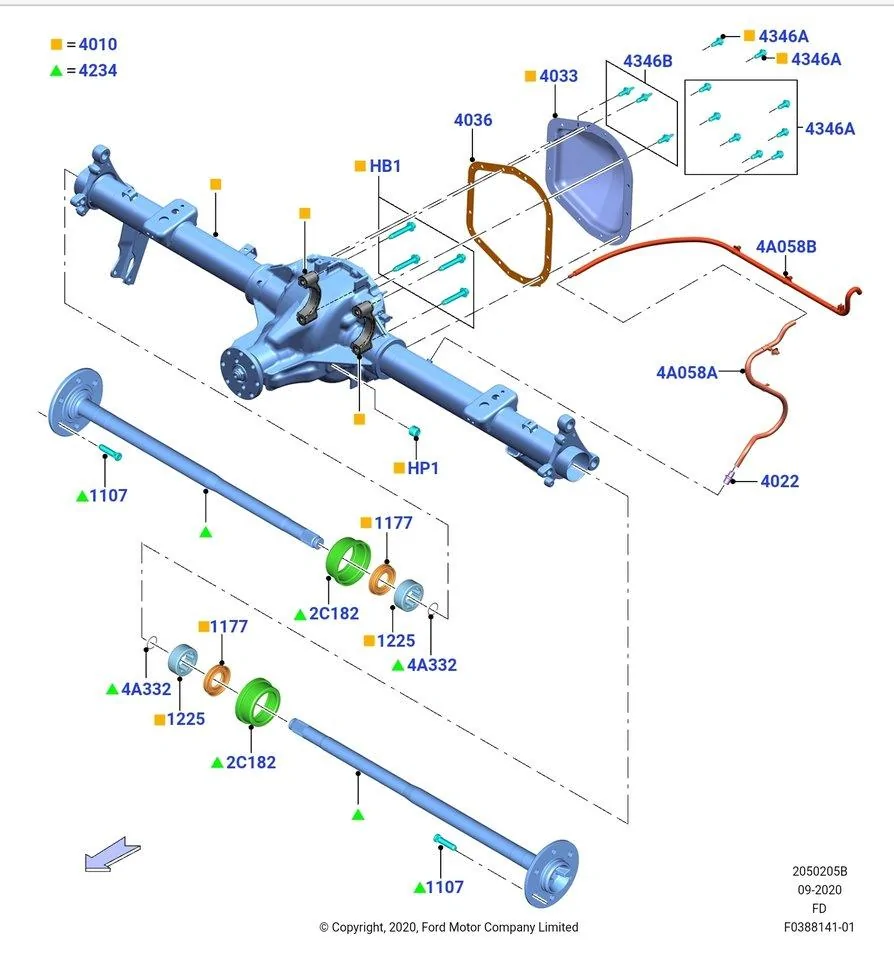

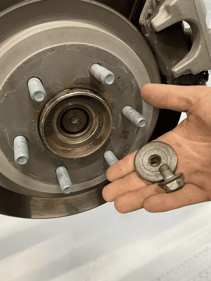

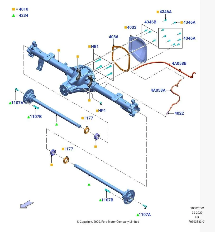

I'm not sure why this is still a matter of confusion, especially when it could be easily rectified by people with MaxTow checking the ends of their axle tubes, or even better, taking their wheel off and seeing if they have the 3/4 float bolt at the end of their axle.
I've seen other assurances that MaxTow gets the 9.75HD axle, but they seem to go unheard.
Pic from a 2021 Powerboost with MaxTow who found his axle bolt broken.
Ford F-150 Powerboost with Max Tow Package Question 1647570331044
You can also see how the axle tubes are different between the standard:
Ford F-150 Powerboost with Max Tow Package Question 975 Standard
And the 3/4 float with hub assemblies bolted to the axle shafts:
Ford F-150 Powerboost with Max Tow Package Question 975 HD
I would assume this is also why you get the larger brakes, but it looks like same brake caliper (tabs on axle housing are just moved further out).

Another PowerBoost with MaxTow and the broken axle bolt:
Ford F-150 Powerboost with Max Tow Package Question 1647642198710
Plus 3 other people in the thread that have PB MaxTow and broken bolts
I would bet a 6-pack of beer that MaxTow gets you the 9.75HD axle, which would make it well worth it...if I didn't just comb a thread with like 5 axle bolt failures....

Is the flange where the axle tube meets the rotor also a few inches thick, vs a flange just the thickness of the brake flange? This area right here:
Ford F-150 Powerboost with Max Tow Package Question 1647647314510
