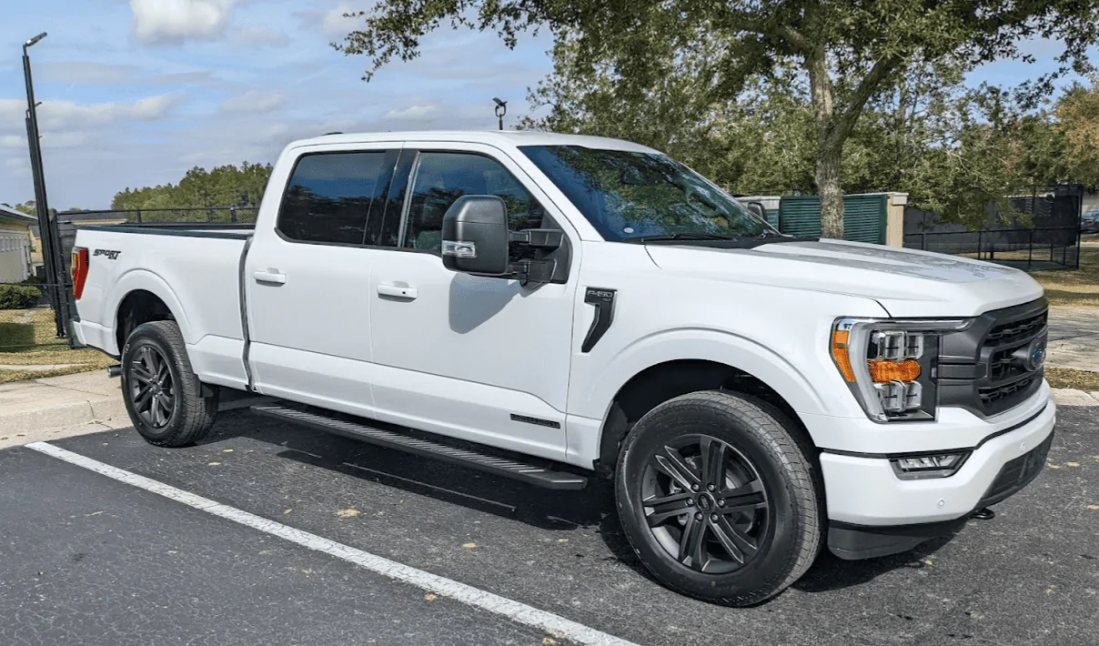

2021 F150 Hybrid Powerboost
I have a 2021 powerboost XLT 302A, FX4 off road, XLT Sport, 4x4, 373 rear, 2.7kw gen, gvwr 7350, combined wt 1619, 145 wb, and I quote from the sticker "trailer tow package" and I still find it confusing as to the trailer capacity I can tow. It's either 11000 or 12400 pounds. The chart from ford is 17000 GCWR for 11000 and 18400 GCWR for 12400. So is there a quick way to find out towing capacity. I am assuming 11000, but not completely sure. I tow a 34 foot 7600# coachman travel trailer. Not yet towed over the road.
