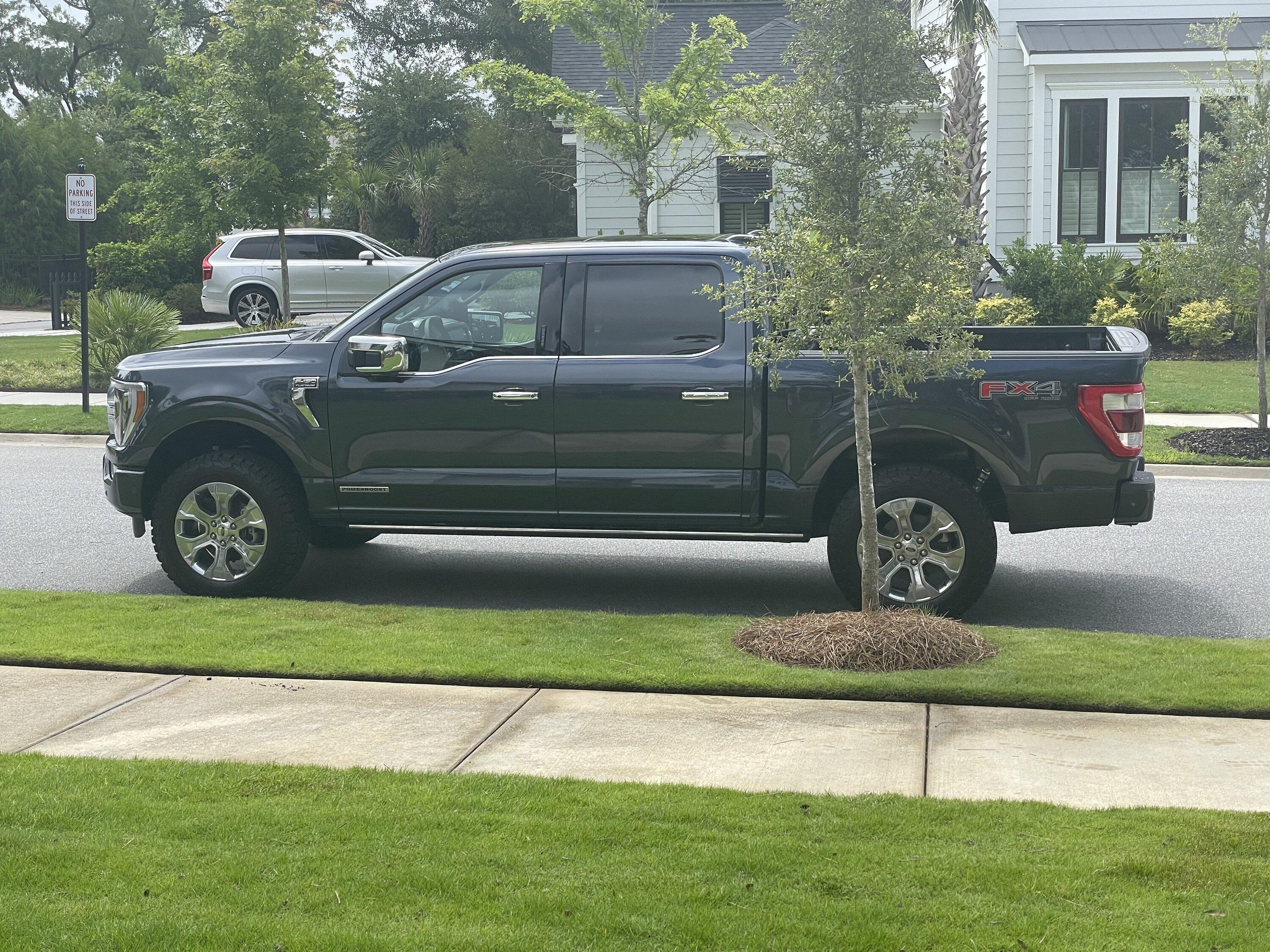

My opinion is that it rides great. It took me a few days to get used to the firmness, however it’s much more “planted”. Doesn’t feel like a lifted truck.

Thanks for the feedback. I assume your installer adjusted the lower perch ⅝” as specified per Roush? Do you know if your rear shocks were shorter than oem as noted by somebody else in this thread?

Thank you. They did adjust the perch and I’m unsure about the rear shocks, the dealer managed the install prior to me taking delivery.
Previously, I had a ‘21 with 1.5” puck in the front, same tires. It rode very comfortable but the Roush fox setup is close with added stability. Can’t go wrong with either.

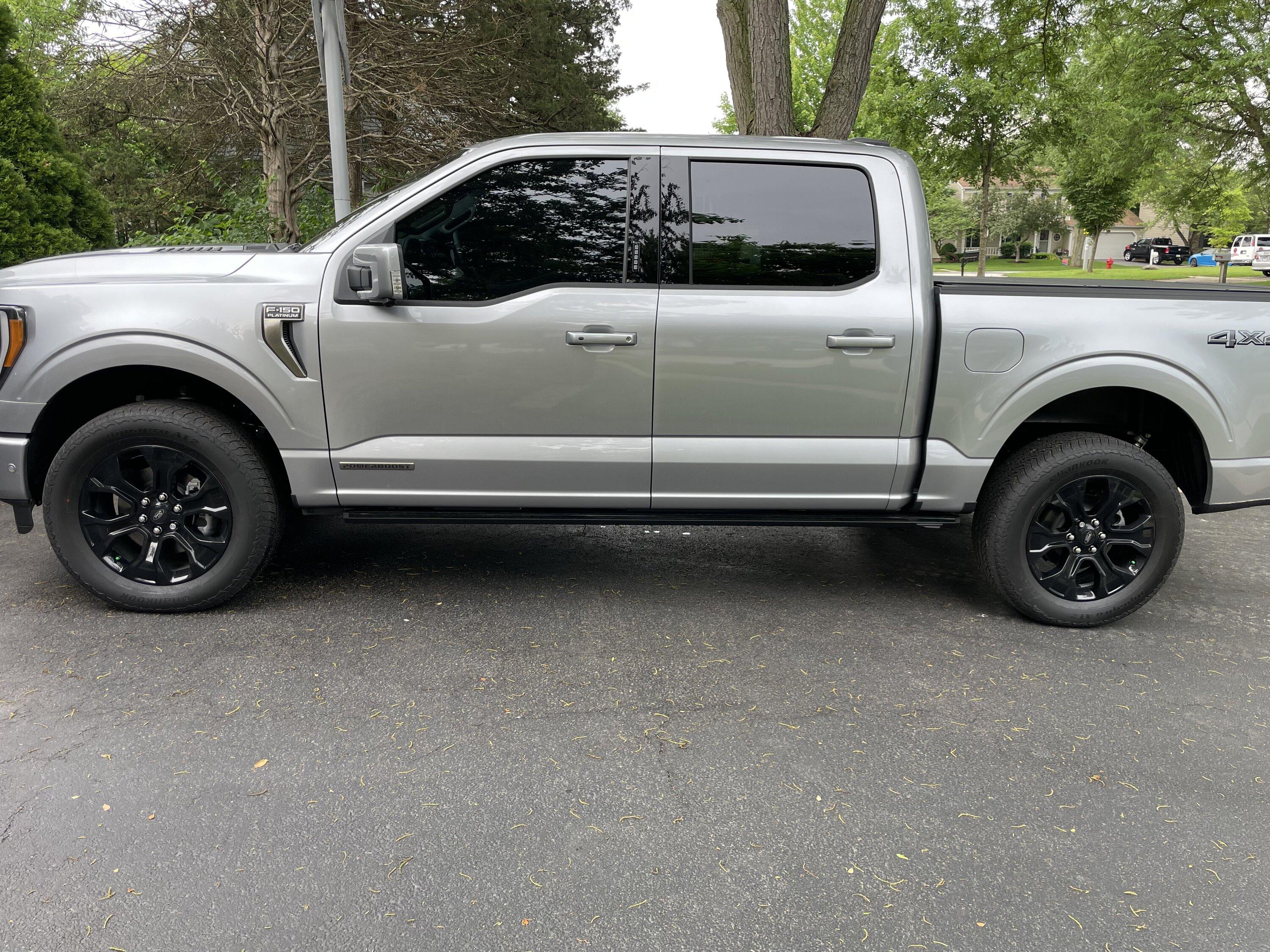

I have a very similar issue to the OP. I have a 22 platinum PB. I have installed the new 21-22 specific Fox 2.0 level and only got 3/4” of lift. I have opened a case with Fox and they are looking into the issue. They did tell me they have another PB case where the guy got 7/8”. So far the response has been … well it is a Plat PB, look at the weight. At this point their engineers are looking at my case and trying to decide if I should add 1/4-3/8 of preload to get my desired ride height or if I should use the prior gen shocks which have stiffer spring rates. I will keep this thread posted. Photo is on a bit of a slope so it does not look terrible but I do have 2 full inches of rake still.

Does it ride better than the stock suspension?
The ride was good, now it is fantastic. Potholes and speed bumps don’t exist anymore and the body roll is gone.
the alignment brought the front end up another 1/8-1/4 inch. I tow long distances so I am leaving it alone and enjoying the better ride.
