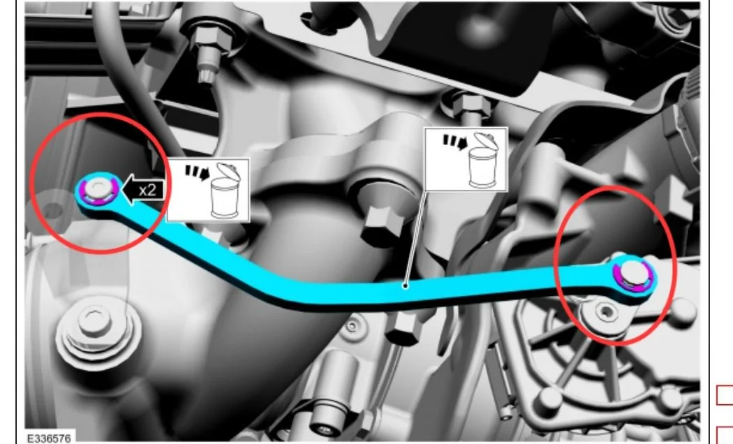

Powerboost squeak normal?
Just curious....
Does anyone know if the squeak is from the link-bar/e-clip external surface itself? Or is it internal to the actuator housing? (blue)
Ford F-150 Powerboost squeak normal? 1000020075
Ford F-150 Powerboost squeak normal? 1000020081
ProHERO
Mar 11, 2022
105
66
2022 F150 Platinum Powerboost
Just curious....
Here are a couple clips of the squeak. To me it looks like the noise coincides with the linkage moving. With a little bit of high temp grease seems to give it temporary resolution.

I guess I was hoping for a permanent fix even if I had to replace the actuator and arms and either attempt to install myself or let the dealer do it.
Nonetheless, @ProHERO any idea exactly where I need to apply the grease. I see both ends moving but can’t pinpoint exactly where I should apply the grease and the dealership did it so minimally I can’t even see “grease” applied but they must have because the noise is temporarily gone, again.
ProHERO
Mar 11, 2022
105
66
It’s hard to tell which end of the actuator the noise is coming from but I would grease both ends. It’s just an e clip holding each end on. A screwdriver can pop it off but be careful as that thing can go flying never to be seen again. And also be sure to note the orientation of the actuator arm. The last thing you need is for it to be put on backwards and it bind up. I assume the grease may not be holding up due to the high temps of the turbo burning it off. But I think you mentioned it before to make it a regular maintenance item.
I’ll try the spray that was recommended to me and see if I can shield behind it to prevent overspray but maybe that will be easier then risking taking it apart and screwing something up which I have done in the past lol. You think this I bought would suffice? The ford dealer told me their high temp grease withstands about 450 degrees but what I bought claims 1000 lol

That should work. It’s a lot better than what I picked up. I think it’s WD40 dry lube. It’s good up to 500 degrees which hasn’t been working as well as I thought it would. After a couple weeks the noise came back. Let me know how yours turns out.
So I'm guessing that if external application of lubrication can eliminate the squeak, even if only temporarily, the source of the squeak is in fact friction between the actuator arm and the pivots that it is clipped to?
That's encouraging since there may very well be a better remedy than using a spray on that doesn't last.
Whats so strange is why this isn't more widespread? And why Powerboost exclusive? Or is it?
