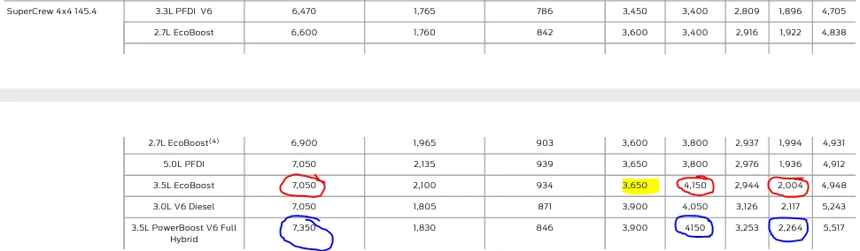

You can work the other direction and start with the curb weight of the truck configuration you started with and then add the weight of each option, which would be what you subtract from GVW.
Folks can get within a few lbs with due diligence.
This is the Ford document provided for folks to do the worksheet and get close to Cargo Capacity estimate before the build.

Only 25 lbs for the tonneau cover. What the heck is that made out of. I have a Ford quad fold aluminum top type of cover and one quad alone would weigh 25 lbs.
Truck came in at 1320 without the tonneau cover and only the 2.4 system with tow mirrors and no bed liner, pretty much everything else though. 6.5 foot box
If you got a PB 157" then I'm guessing you got the 4000# front axle and 4150# rear, with a GVWR of 7350#. That's a comfortable margin I would say!
Personally I'm really happy they beef up the front axle so much for PB even though the battery is basically at the center of gravity point. I keep the bed of mine basically empty and the trailer tongue weight definitely does not take up the whole rear GAWR capability, especially weight distributed. It's the front axle that will hit GAWR faster with driver and passenger and weight distribution hitch all included.
Ford F-150 PowerBoost GVWR Question 1639621374115
Ford F-150 PowerBoost GVWR Question 1639621516582
(FYI: The yellow highlight is INCORRECT. Every EB maxtow gets a 3600# front axle not 3650#)
If you look at the rear GAWR margin, it's too much! No one is putting 2k pounds of tongue weight on there. Then for the battery weight, they compensated the PB front GAWR by 300# and kept the same rear axle as the maxtow EB of 4150# because its too much margin. (Yes, there is a fulcrum effect but proper weigh distribution will compensate, but front axle will still hit limit first with passengers)

I think marketing is what "allows" the PB to carry 300 additional pounds.
If they didn't raise the GVWR of the PB, the payload would be suffocatingly low.
If they raised the GVWR of the non PB motors, they would risk canibalizing high margin Super Duty/Power Stroke sales.
There may be some small strutural differences...but I think it's nothing more than dipping into the built in payload margin to make the PB more attractive.

The small structural difference is a 300# stiffer front axle spring. That's it. Same tires, same frame, same rear axle (vs max EB). They mapped that front axle GAWR directly to the vehicle GVWR, plain and simple.
Turns out the front is 4000.
