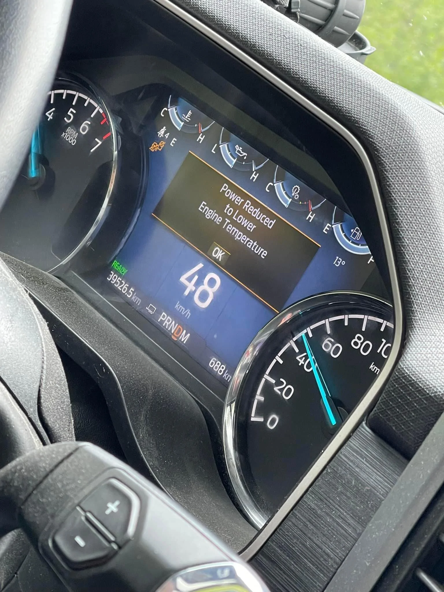

Truck goes into limp mode when towing but it’s inconsistent and doesn’t occur consistently, dash warning shown here. Dealer thinks it is the heat exchanger but have been waiting TWO MONTHS with no ETA on teh part. I’m not having any coolant leaks and the fluid levels are good so I am skeptical that it is the heat exchanger. Has anyone had this same issue? I should also add that I get a whole
Laundry list of warnings and error codes with the app as well. Oh and unrelated, but this same truck also blew the drive shaft at 40,000 km, to see im
Frustrated with this truck would be an under statement!

I would agree with your dealer. On the heat exchanger - there is an inlet and exit temperature sensor. One code the truck knows is an unreasonable difference between inlet and exhaust temperature. You’ll see in the attached photo - in which I have a code for exhaust heat exchanger valve failure - my coolant temp is fine, but my truck is still saying engine power reduced - presumably due to delta between exhaust heat exchanger inlet and exit temps. I waited almost 4 months for the part and the replacement heat exchanger fixed the issue
Any idea if the heat exchanger is the Same part on the 2021 and 2022 powerboost? If so, why are the parts not available when I assume they are still building new trucks that have this part?
