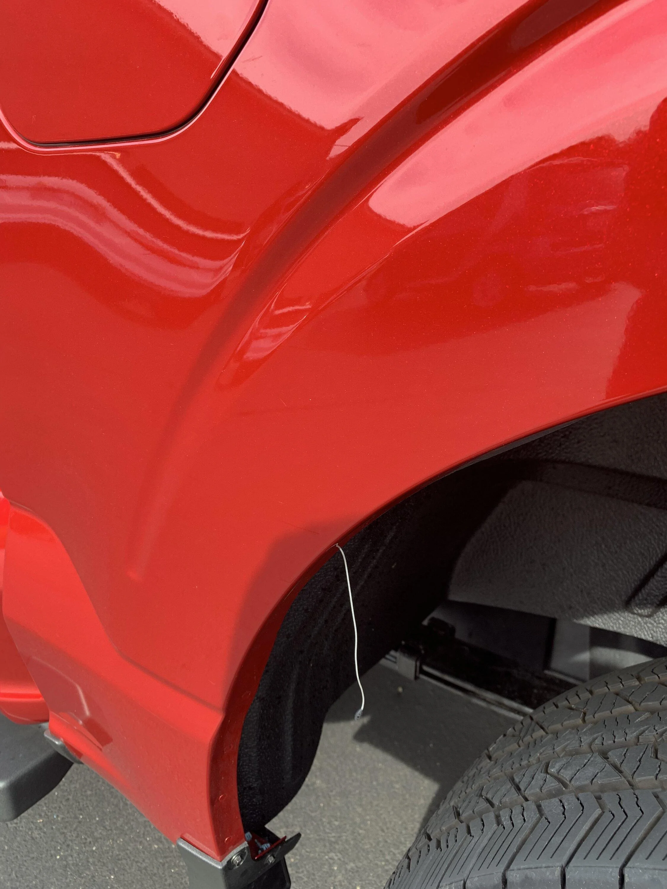

It is hanging out of the rear drivers side fender? Why?

Emergency fuel door opener. Pull it to open

But why is it hanging out in the open? Shouldn’t it tuck away?

Another thread reported that there is a lip that it slips under but it isn't contained very securely by the lip. Mine is contained behind the wheel well liner.

There is a body hole in the wheel well, I slipped it through there.

Mine slipped out too. No big deal... Nice that there is a manual release.

I taped mine too the wheel well liner. Used blue electrical tape easy to find if needed.
