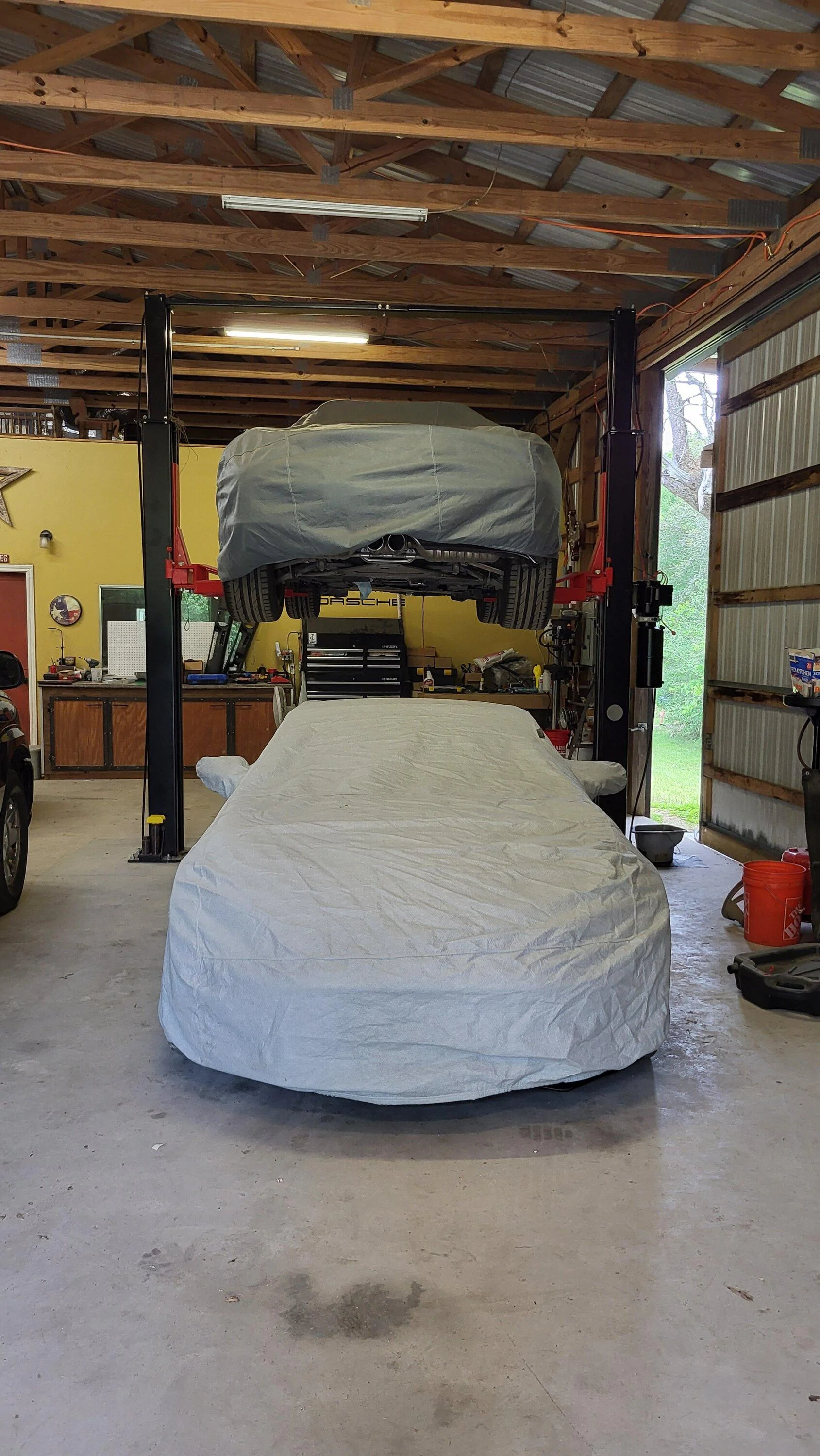

But I'm spoiled a bit. Just have to move a couple of toys out of the lane in the barn ?

When I see someone with a lift, I think about how the good book tells us not to envy our neighbor, but I go ahead and do it anyway. How tall is the ceiling there to allow you to lift a truck?
I think 14' to the bottom of the trusses.
But I'm 6' 1" and with the truck on the lift I can't just stand tall and walk under it without caution.
Doesn't matter though. I use a roll around office chair and usually lift whatever vehicle to the appropriate height for what is a comfortable reach. And it's all about the lighting too.
I'm old. So I just lalligag and take more time prepping and staging the tools I'll need on a rolling cart. Finding the right Playlist to listen to. And making sure my ice tea thermos is cold.
If it's not going to be enjoyable, I'll find something else to do that is. Lol
It's great to get old. At least in some ways.
