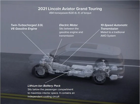

Wow, What Lincoln world beating monster so you speak of sir?
500hp 600tq and can operate on battery alone.

Impressive! Why the 0-60 only 5.4s and how did they fit the 10r80hmt elongated linear hybrid powertrain in that wheelbase? 12" driveshaft?
That vehicle isn't that little.
But yea, both it's driveshaft and our F150 Powerboost drives shaft are a few inches shorter.
The traction motor isn't really that big.
A 400V 100HP/200ftlb electric motor doesn't have to be very big these days.
Hopefully the next Gen is 800V? ?
As for the 0-60....
Ford (and others) gimp performance all the time to nest it right where THEY decide it belongs in the market.
Toyota built a relative clone of the 3.5 Ecoboost. They released it with just barely more HP/Torque of the competition.
Yet both motors have ~100HP untapped on pump gas.

Aviator uses an Explorer chassis and it uses the same linear setup as the PB?

Did some research on my own lol, and it is almost as heavy as my F150pb! 5,673lbs. I'm thinking it's really designed for "Grand Touring" i.e. long distance travel in style more than road carving. Never mind. 80 grand for Sync 3? Please. C'mon Ford.

But it's a Lincoln! It's this whole other thing, and definitely not a gussied up Exploder! In the same vein, one of the interesting tidbits I gathered from the venerated Ford tech was that Daimler was also part of the 10R80 consortium, and while he thought that GM makes their version in house, Daimler actually builds many of the ones that go into Fords. The nameplate may be the single least useful bit of information about a vehicle.

Thanks for that graphic. Series hybrid like the PB. Unlike our trucks it will steadily run down the battery correct? The regen won't be enough after awhile and it will need to charge that big battery. Crazy range figures!
Samson16
Mar 24, 2023
3,622
3,587
Orlando, FL.
Aviation systems
Update...nope it will steadily charge itself back up to 75% and works just like our trucks but it can go much farther on electric alone. Heavy like a PB. Performance like a PB. At 6000lb. it handles like a PB. Trade the mpg figures for Sync 4, a 12" screen, cool zone lighting, a nifty bed for your fancy luggage, and go get a Powerboost!;)
