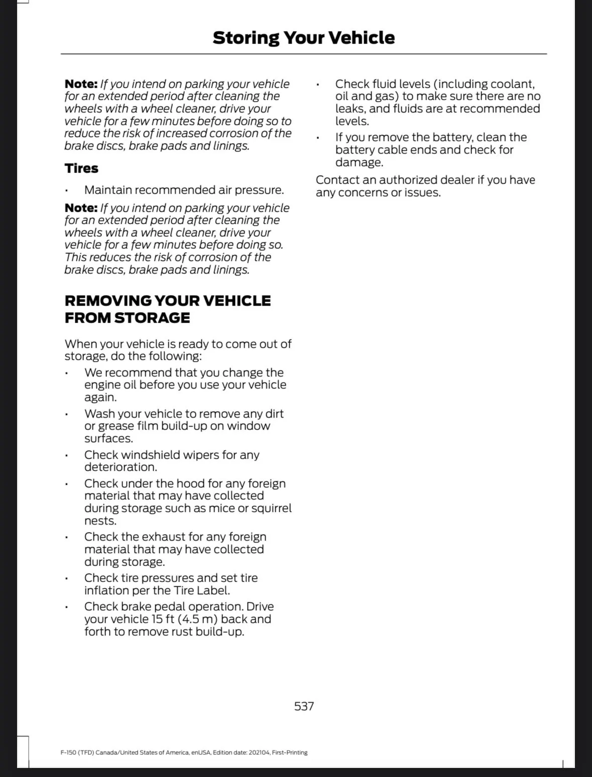

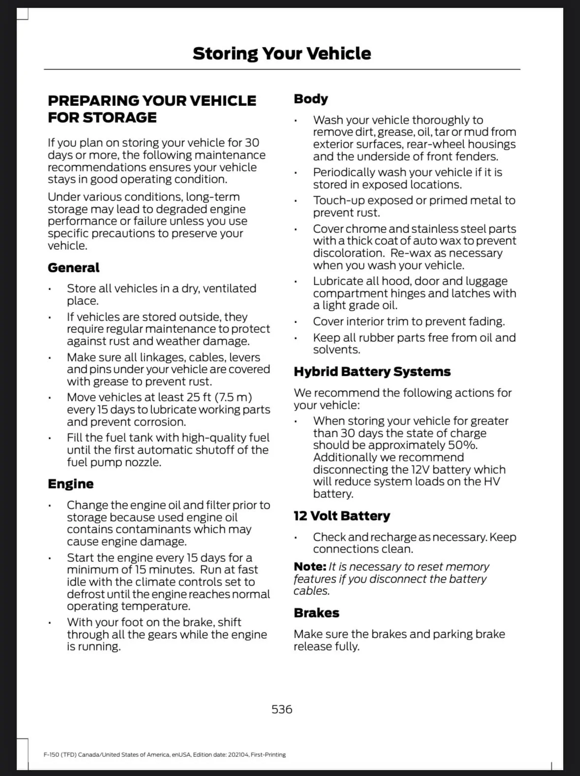

Mine goes to sleep every 2 weeks, so remotely start it when you can, but only 2 times...

so question from the post above...
It says to store with the hybrid battery at 50%. How is this accomplished? I didn't think there was a gauge, and you can't force it to electric only. Maybe using the generator?
I don't have the truck yet so can't experiment.

I believe that he’s trying to find a way to learn the vehicle’s state of charge (SOC), so that he can follow the owner’s manual instructions of keeping the battery at approximately 50% charge.
@FTMS: As far as I know, the generator mode will not display SOC; that information is only possible to learn using special equipment that most owners won’t have.
SOC is a PID available from multiple apps using an OBD adapter.
I monitor several of the PIDs related to the Hybrid portion of the drivetrain on the Powerboost. The two most revealing is the rate of charge/discharge of the battery (measured in Amps) and the SOC of the battery itself.

@Snakebitten : I think he was adding to my comment. Just doesn't make a lot of sense for the manual to specify that it should be stored at 50% when there is no built-in gauge and I'm also not sure how you get to the desired 50% if you don't really have control of the charging... or maybe I'm just missing something.
Good point. How would we know?
(I don't think you are missing anything)
I believe the manual also suggests disconnecting the 12V battery?
But one way to make sure you are at 50% or above is to not shut the truck down until you are parked and waiting until the ICE comes on and then shuts off. At that point you would certainly not be BELOW 50% SOC
