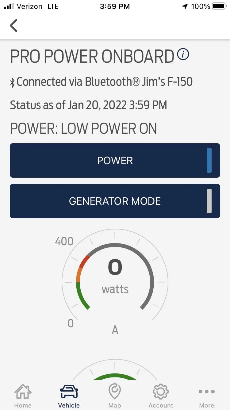

I'm not fussing with the dealership. I'm following in the footsteps of the pioneers on here and have ordered the ODB interface and will license FDRS for le$$ than the dealership charges to hook up to the truck.
After seeing as many as 7 modules for Job 1 trucks being gimped, I'm ready to get my FordPass remote control of the Powerboost generator back. :)
(we had it 7 months ago)
Big thanks to you fellas for laying the groundwork.
