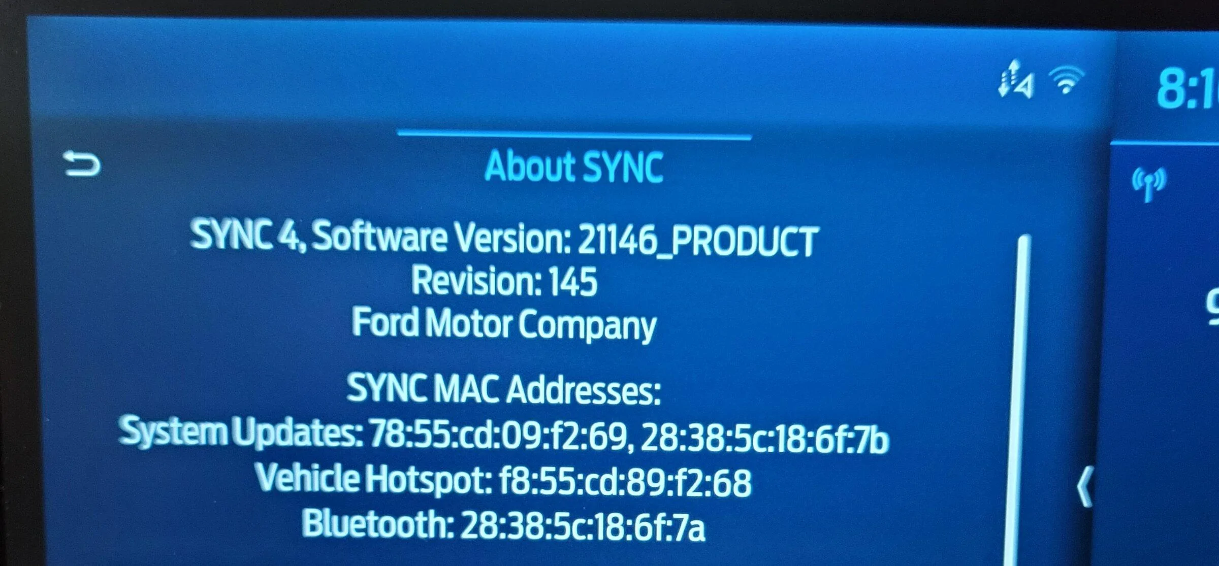

Well, like many here I got my new APIM installed and received a few updates including 2.1.
  1. Now my phone pairing disappears each time I turn off the truck, so I have to repair each time I start the truck.
  2. FordPass does not keep authorization after ignition is turned off and on.
  3. Music album image doesn’t display for Bluetooth source.
  4. Approach detection is sporadic.
Ford F-150 Power-Up 2.3.0 OTA rolling out Sync Version
Hmmmmm
I was at that build and revision and did not experience those symptoms. I wonder if there are other modules that need to be "match up" to get everything to work?
I ask because when I update my APIM I am required to update my TCU as well.
Can you send me your vin so I can look and make sure they did what they should have when installing it

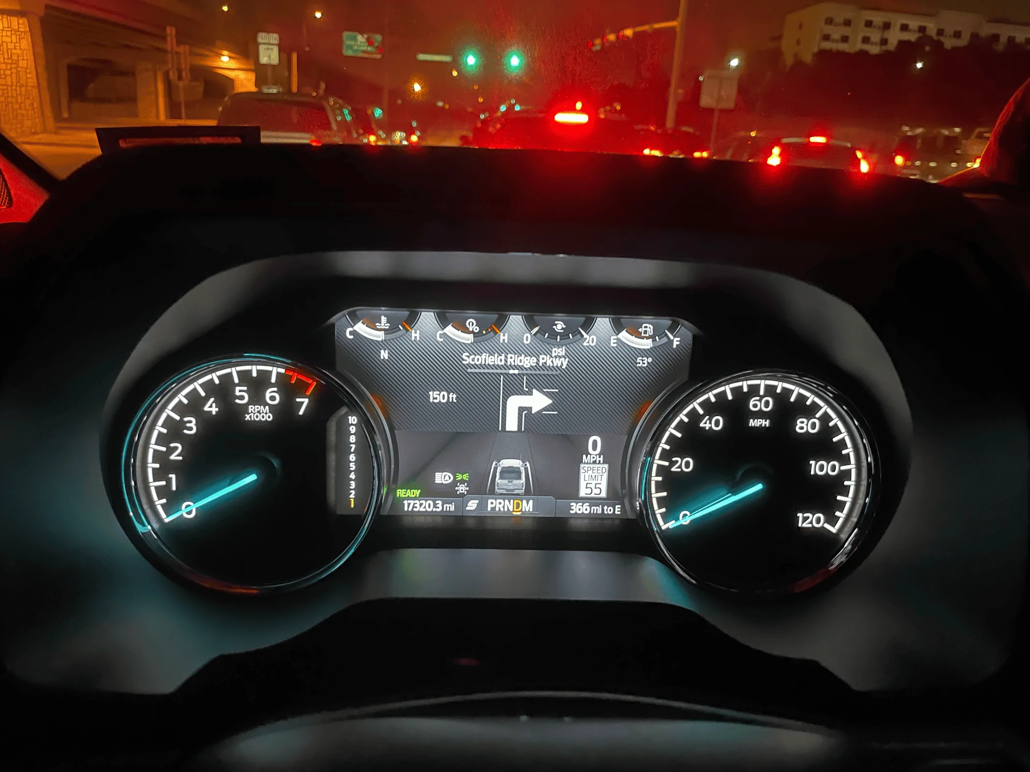

Also, my 8'' dashboard now has feature parity for Apple Maps that is standard with Sync 4 navigation. It's really quite great:

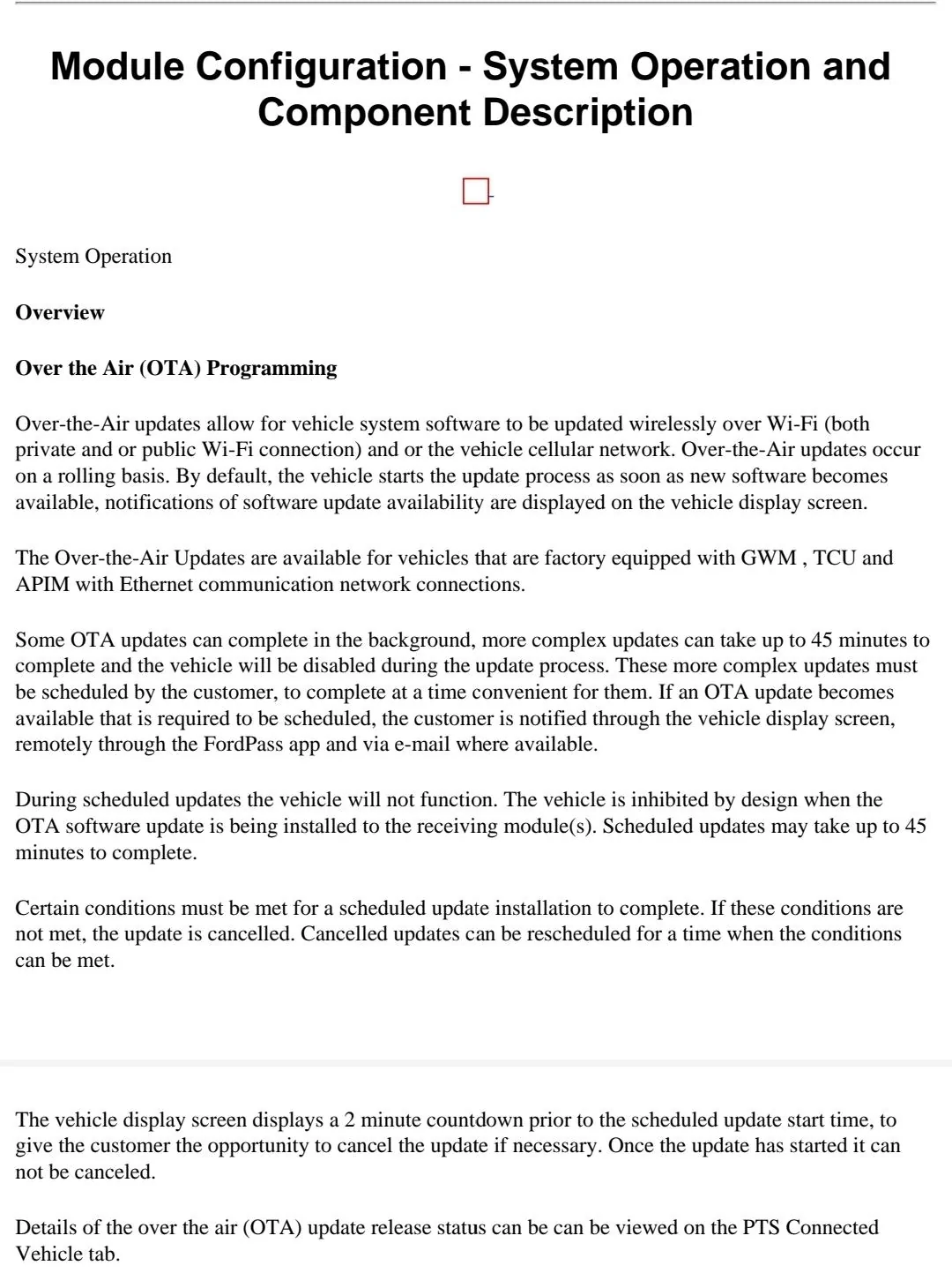

I wonder if this might explain why those that reported that they set a "schedule" for OTA suddenly succeeded at getting the APIM update, while others that did not set up a schedule haven't? If I am reading this correctly, some updates, those that would require the truck NOT to be driven while being updated, are possibly ONLY delivered if "scheduled"?
