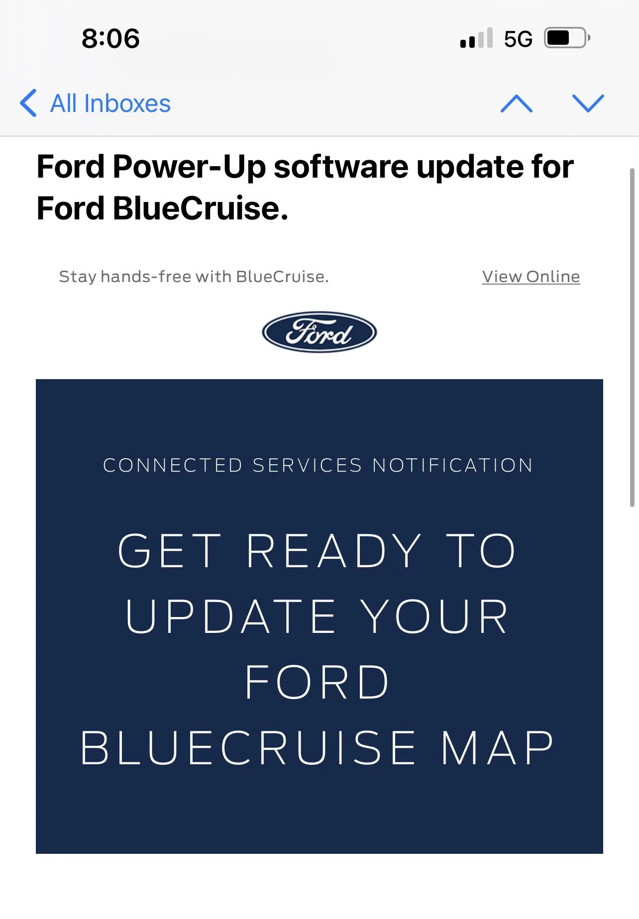

Not sure what version this will be but it looks like I have an update coming soon - got this email this morning but no update yet.
Do you already have Blue Cruise enabled on your truck?
