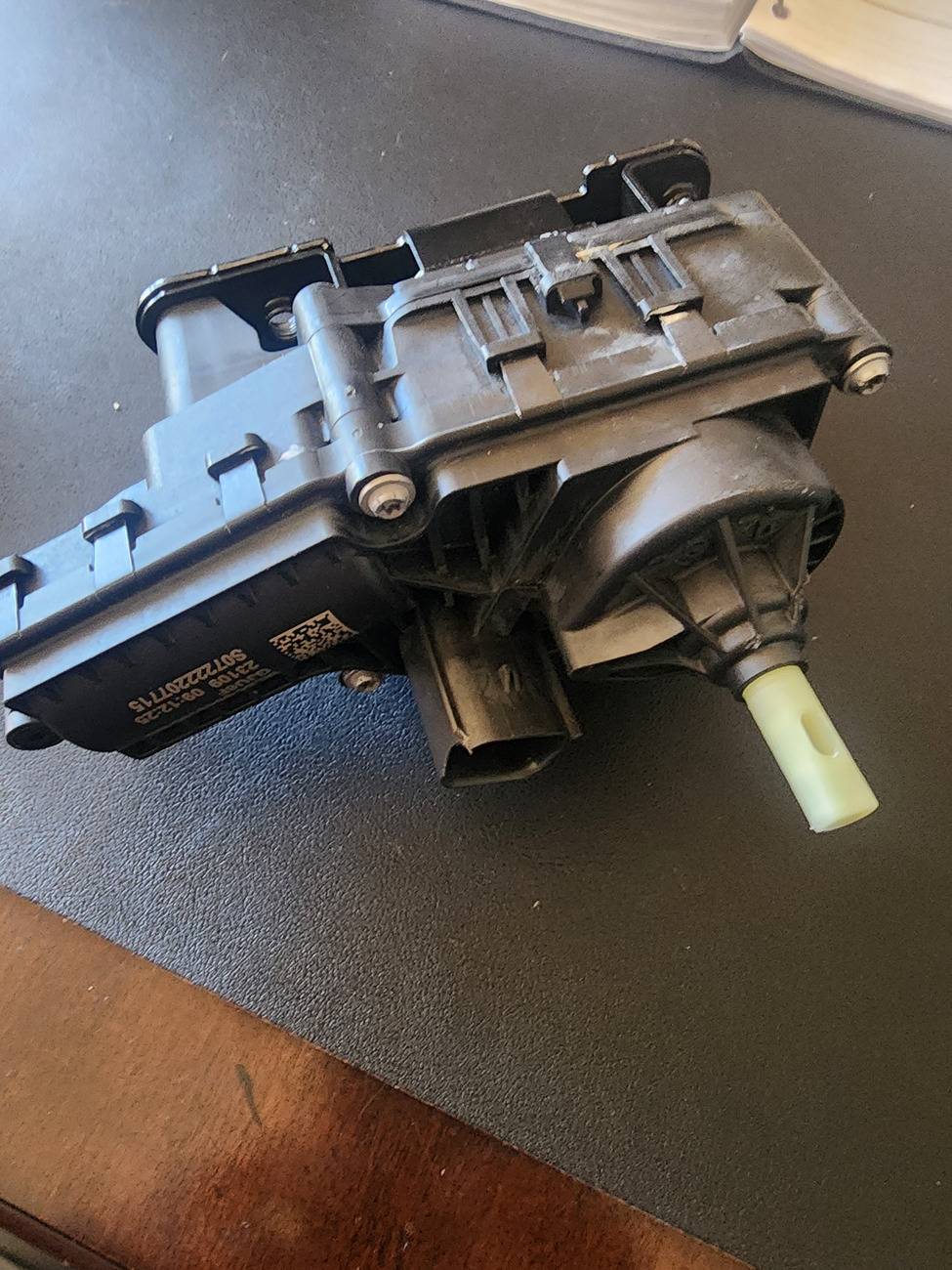

Where my issue has been with the exact same problem all started with the tail gate not closing all the way on the right side. Then the assist lift function would work sometimes and not others. Then the 3 beeps happened one morning and the gate never attempted to open or auto close in any manner. By remote, dash, or the gate button. I changed the power supply module first, then the motor, I then had a Ford Tech hook a computer up to it and he allowed me to watch over his shoulder. The module in the gate was doing everything it is supposed to as far as communication but was not allowing and input from the computer to complete and tasks. He could not understand why this was. I think the module is self testing all the components but not sending a code to the truck computer. I changed out the right latch and nothing happened until I manually shut the tailgate and started the truck. Then all was like new again. All tail gate functions are back in order and functioning correctly. In short the beeps are a component failure code that is not reported to the main computer but just audible. Hope this helps.
Ford F-150 Power tailgate won’t open beeps 3x 20241005_150448
