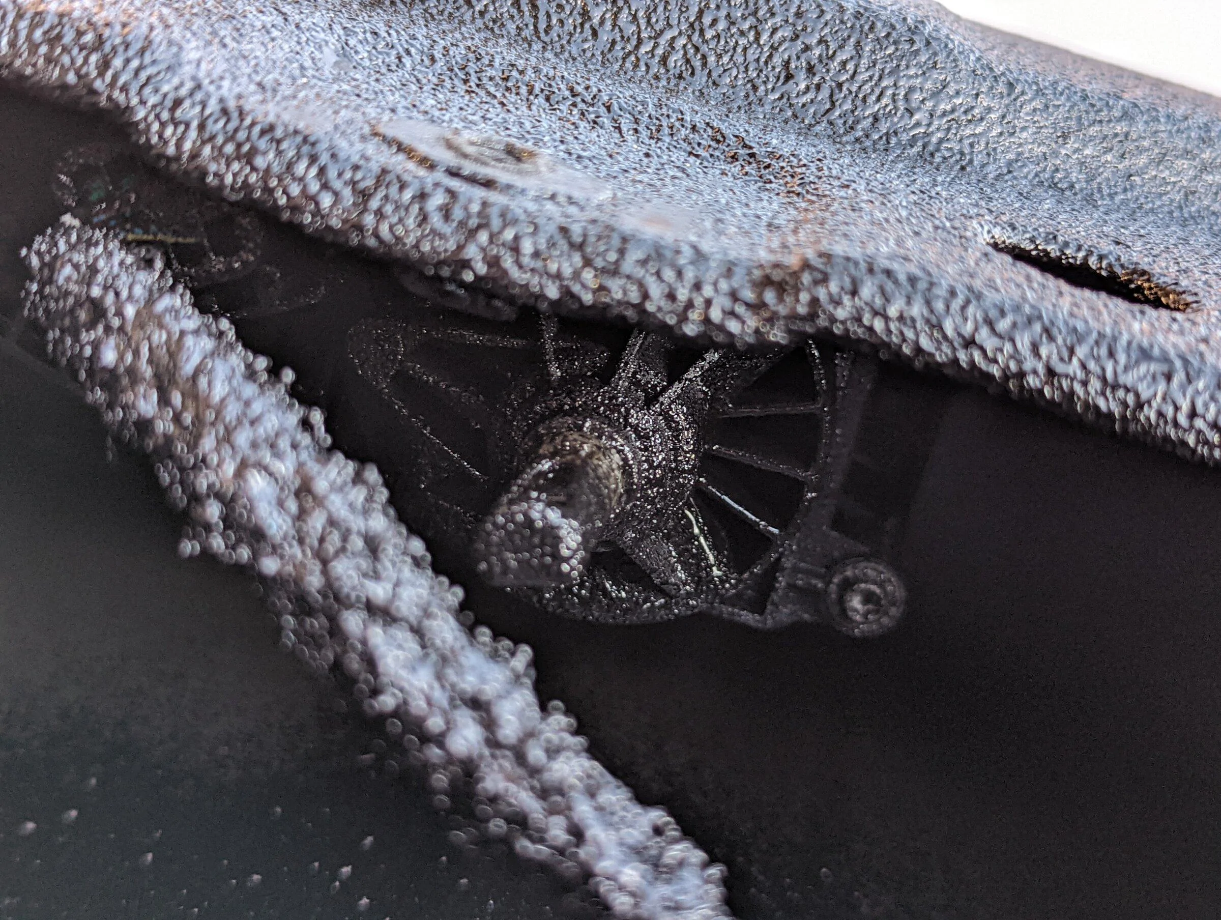

But... Upon arriving home I was hit with the ol reverse park assist unavailable bug. Before carrying it back to the dealer for them to fix I took off my work surface to see if anything was left unplugged and then recoiled in horror:
First, it appears all the work surface screws were overtightened:
Ford F-150 Possible TOFF Liner Disaster PXL_20220210_000747801
These aren't supposed to be rounded off on the ends are they? ?
Next... It looks like they didn't even bother masking the tailgate.
The tailgate motors, the wiring harnesses, all the connectors, and even the tailgate module were just absolutely soaked with this shit:
Ford F-150 Possible TOFF Liner Disaster PXL_20220210_001151877
Ford F-150 Possible TOFF Liner Disaster PXL_20220210_000739156
Ford F-150 Possible TOFF Liner Disaster PXL_20220210_000741740
Ford F-150 Possible TOFF Liner Disaster PXL_20220210_000847436
Ford F-150 Possible TOFF Liner Disaster PXL_20220210_001319034
Ford F-150 Possible TOFF Liner Disaster PXL_20220210_001017904
Is this normally handled this way?
I assumed they would mask off these holes when they sprayed the tailgate.
Am I crazy or is this unacceptable?

get them to replace the harness and module that got sprayed
I seen a lot but never that bad crazy stuff

The first time that connector needs to be disconnected you are paying for a harness. It is not going to be easy to get apart and re-secure.

I hear ya on what you are looking for but if you don't demand they at least replace the motor they will never warranty it out if/when it fails down the road. This may be your only opportunity at this, get everything you can replaced now while the issue is new.

So this morning AutoNation reached out and apologized. Without asking they've offered to replace the tailgate components to get it back to 100% at no cost (they are going to make the spray in bed liner shop cover it). They are currently trying to wrangle all the necessary parts (wiring harness, module, possibly the actuators as well) so they can get me in and out as quickly as possible with a loaner.
Gotta credit them again here. This was not their fault and they stepped up to fix it anyways.
