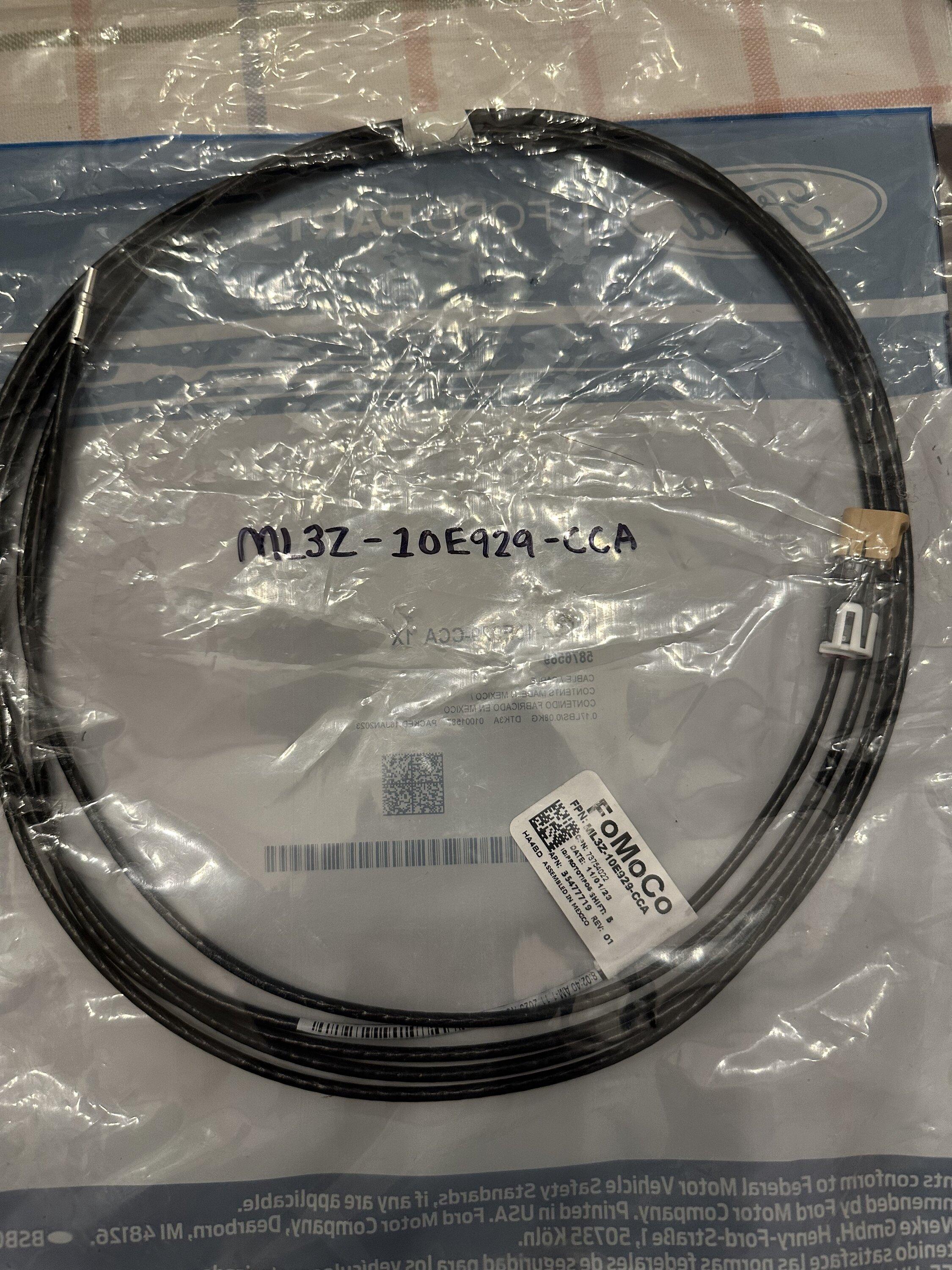

I think that part is ML3Z10E929CCA. I can shoot you a picture of the part when I get home.

The jumper part number is in my last post, it’s the jumper needed from the front camera to the existing installed harness. The jumper part number you sent (CCA) is to go from the IPMA to the under hood connector which connects to the existing installed harness.
The third brake light I’m referring to is the rear cargo cam (above the bed) and needs to have a harness built from the IPMA to the 3rd brake light. 5 wires. I have bought the wire and things necessary already to build it.
You also will not be able to only add one camera. You will have to do the whole 360 cam system at once. I plan on running all the coax and wiring, then installing the IPMA last.

Alright, so the CCA jumper he had listed is needed. Don’t get that confused. It goes from the IPMA jumper CAA.
From the IPMA you have CAA which plugs into IPMA. Then it had a lead that connects to CCA. That jumper connects to connector c1591 on top of the fender on the driver side. From that connector there is a pre installed jumper that goes to the grille. The plug has a dummy plug on it and is inside of a grommet beside the active grille shutter plug. FROM THAT you run the small CDB jumper to the front emblem camera.

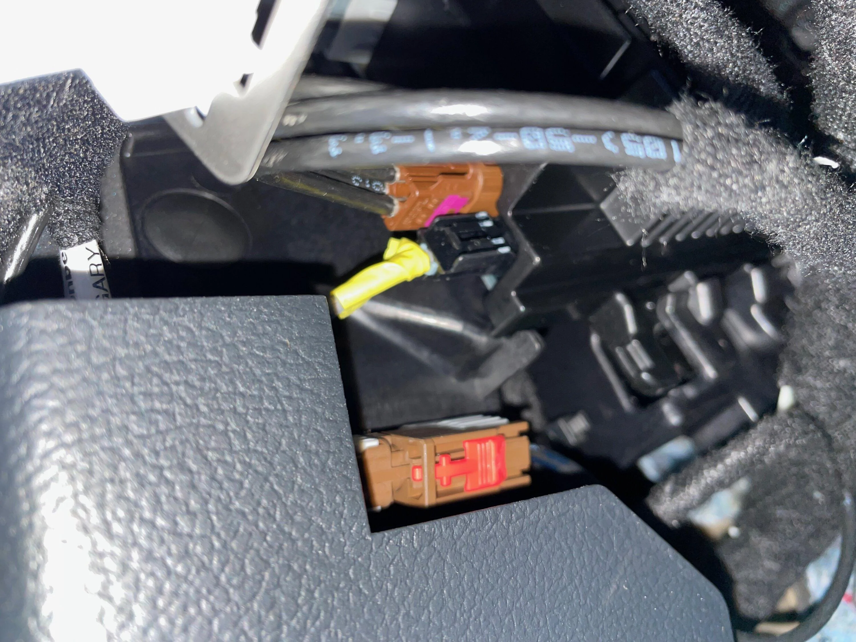

Does anyone know what plug or part number either of these two brown connector are? It's for the rear view camera on the XLT and up trims. My XL doesn't have it but i'm trying to add it along with the other 360 bits.
