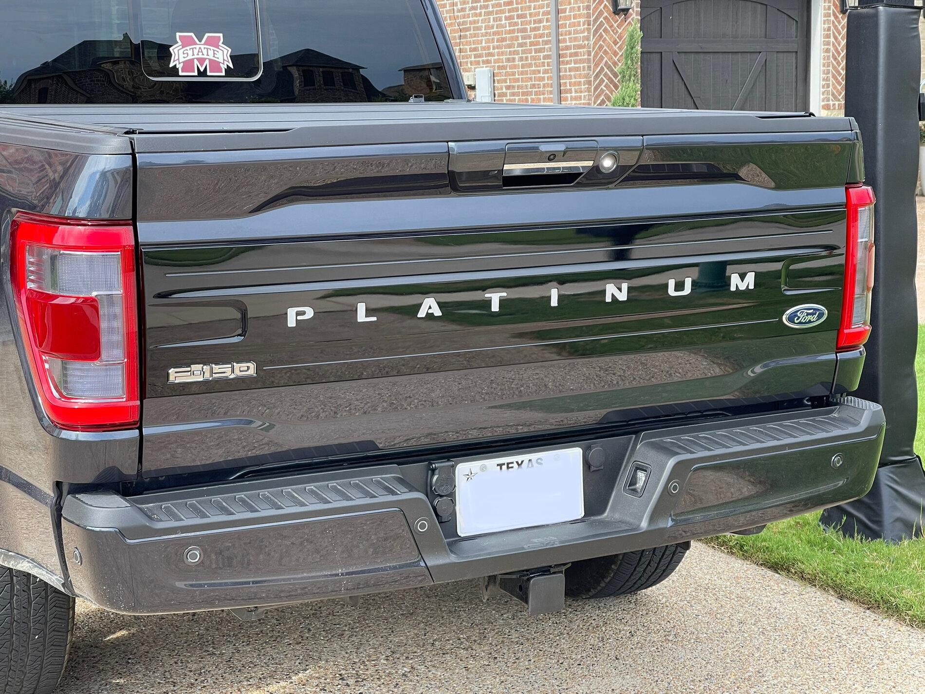

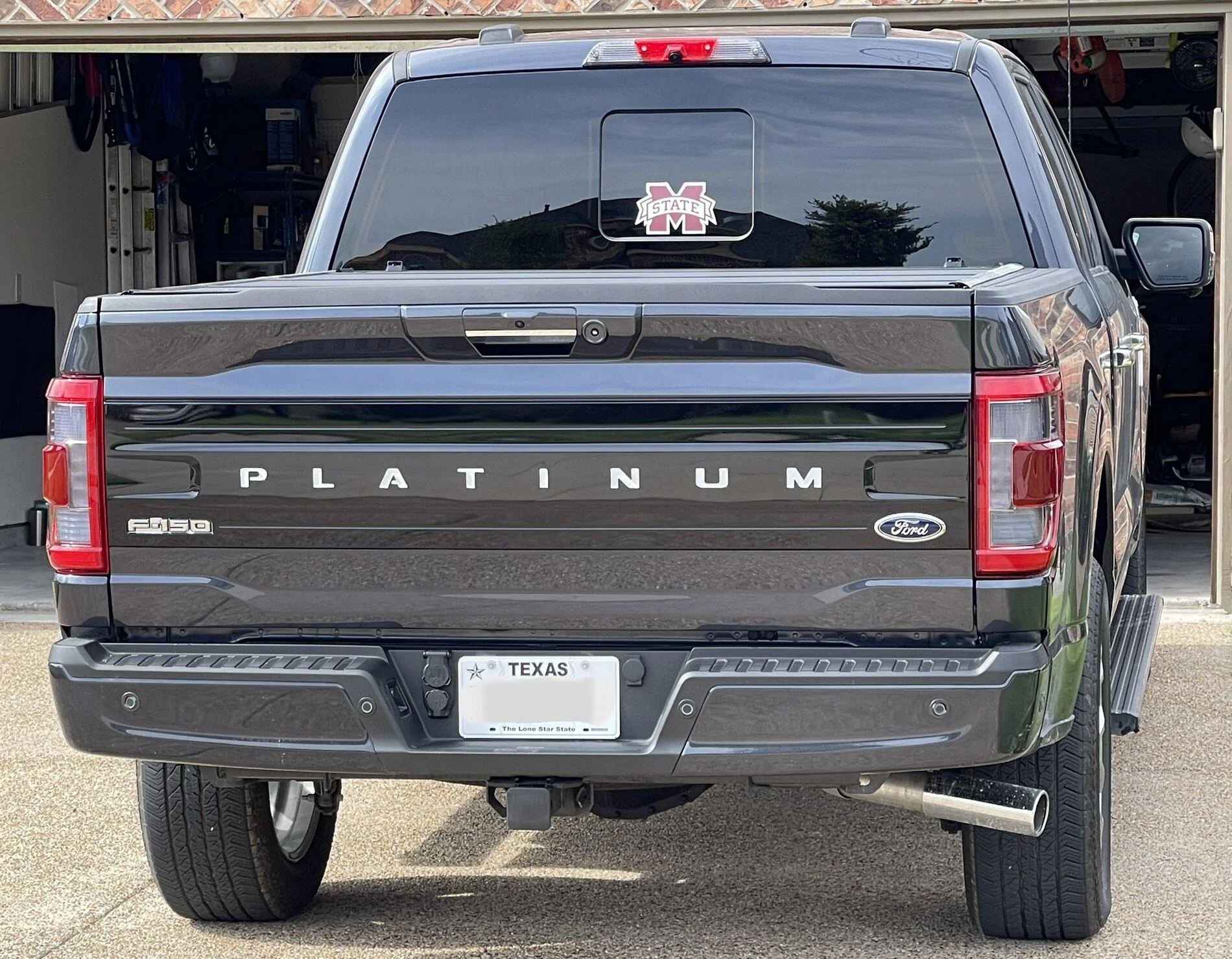

Decided to tone down the silver platinum tailgate. I used Vvivid Ultra Gloss black wrap.
Ford F-150 Platinum Tailgate Plate Wrap 54BF6929-D126-4067-B59E-E90972DDA336
Ford F-150 Platinum Tailgate Plate Wrap 35236AEB-1E22-4C85-ABB9-2F488F838F9D

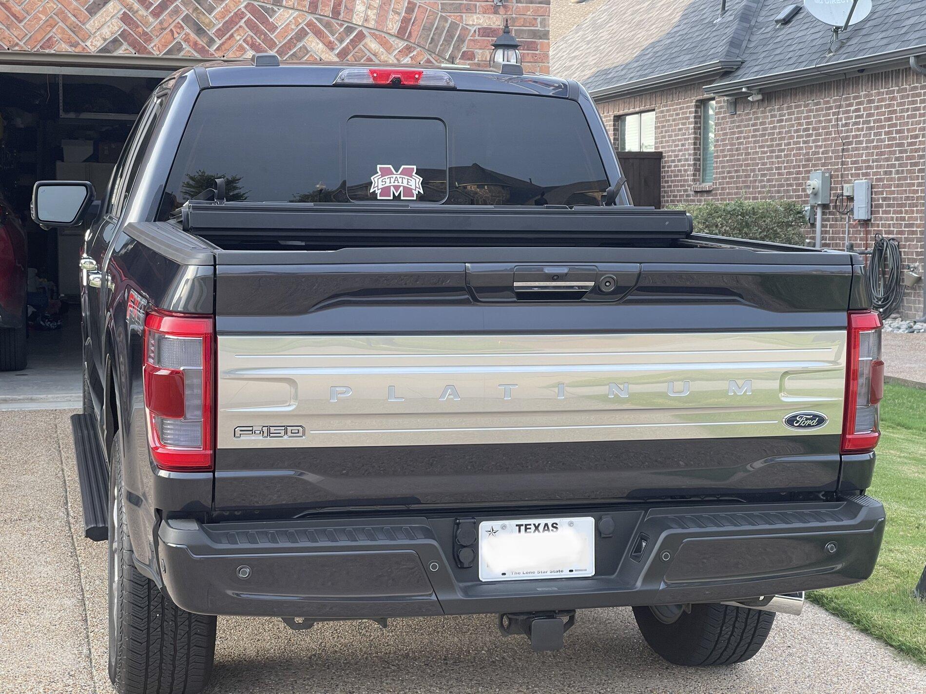

BEFORE PIC
Ford F-150 Platinum Tailgate Plate Wrap 01D6448F-6E26-4134-863E-6C55A77F52B8

That looks so much better!

Wow that's sharp!!

I think I like it. I'm not one that likes murdered out vehicles but nice job. I like your wheel treatment better. ?

Yeah, I’ve never been all in for the total blackout look. I like some chrome. At some point I might switch the tailgate wrap to a lighter gray brushed metal look.

I have very little experience with wrap so take my advice for what it's worth!
Start in the center and work your way out towards the top and bottom. If you're getting air trapped in the two long creases use a pin to make air escape holes, heat the film and press it in again. Don't expect to be able to wrap around the "F-150 letters. I had to cut around the entire badge.
If you're going to cut out the "PLATINUM", don't heat the letters and try to press the vinyl in, cut them out first, then heat and press the vinyl.
Non-glossy will not show mistakes as much as glossy. I'd love to see someone do a dark gray brushed metal like they have at rvinyl.com.
