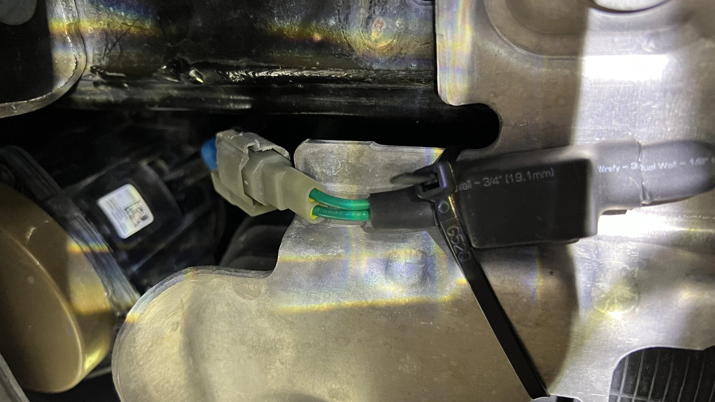

Looks like yours will be there Saturday! You'll be thoroughly impressed with the kit.
Got mine in yesterday and installed it shortly afterwards.
Well made, durable and was an easy install. A bit tight to get to but much easier if you loosen the bottom radiator bracket as suggested in the instructions. Would be just as easy to reverse if needed but I don't see any reason for me to do that till I trade or sell the truck.
Works perfect and no codes, much nicer now on warm days when my window is down. (y)
