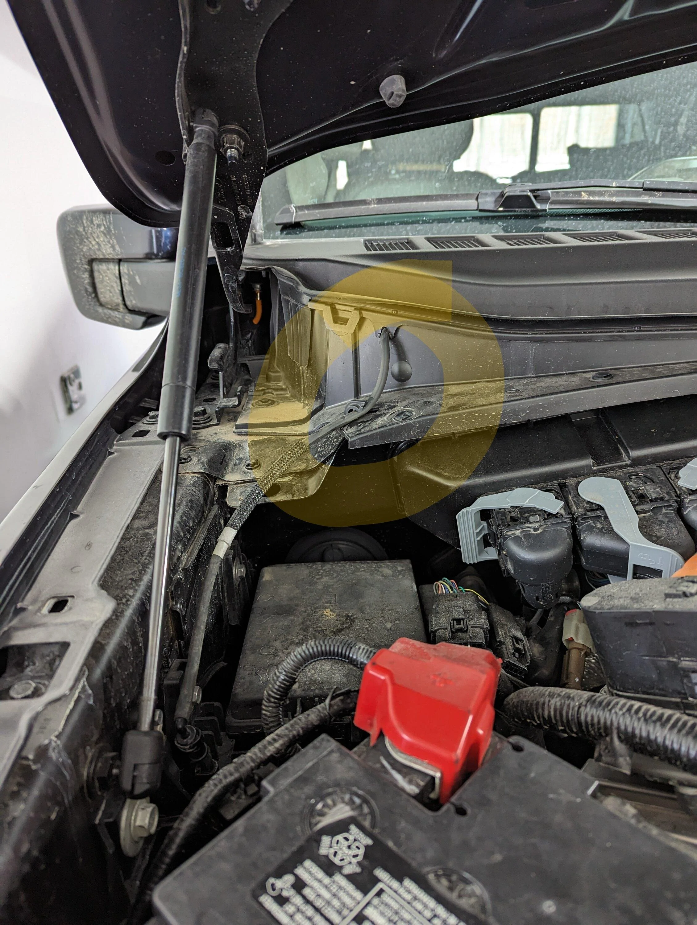

2023 F-150 King Ranch Powerboost SuperCrew 6.5'
Had my hood replaced (damn deer) and after had a weak spray. Figured out the body shop had pinched the hose where it passes through the plastic trim piece. Once I got it back on its path, all was well.
