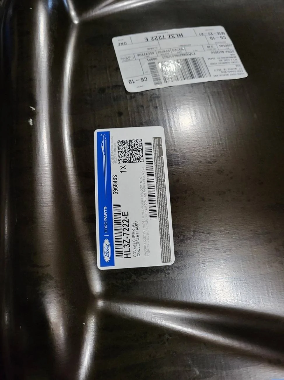

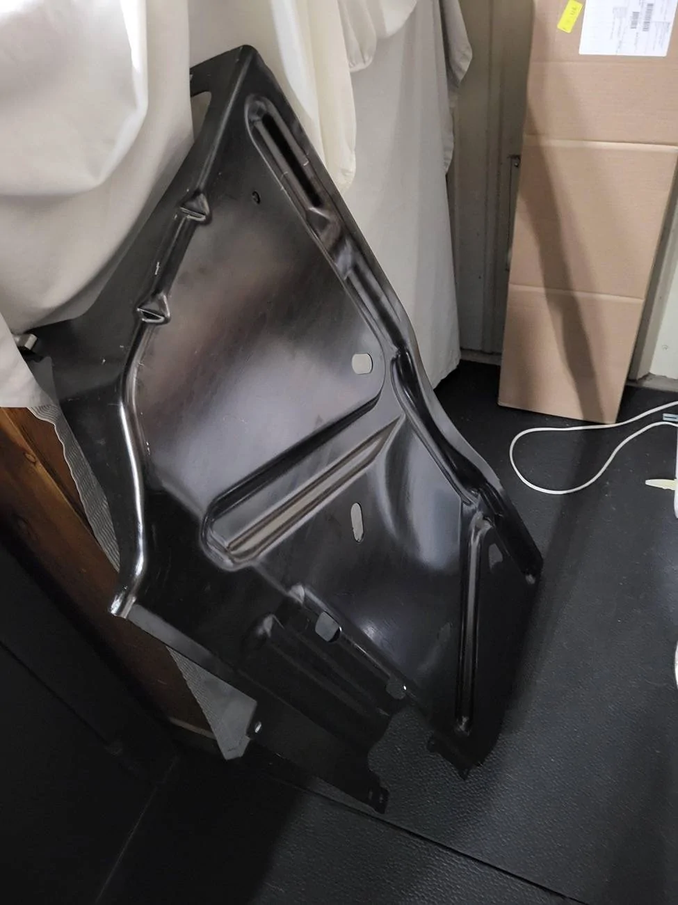

I used one of the older FX4 plates, lower splash pans what if you wanna call them

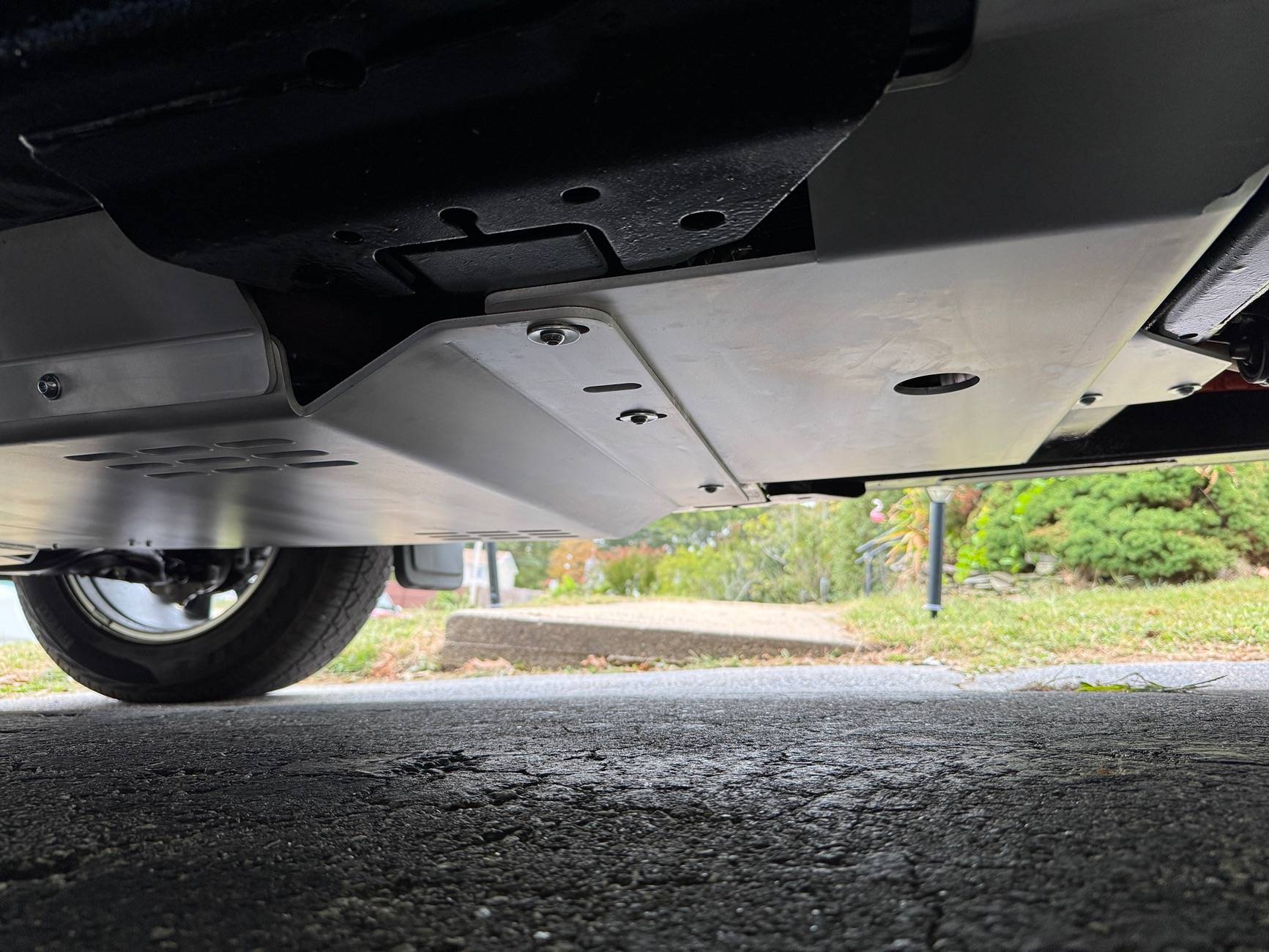

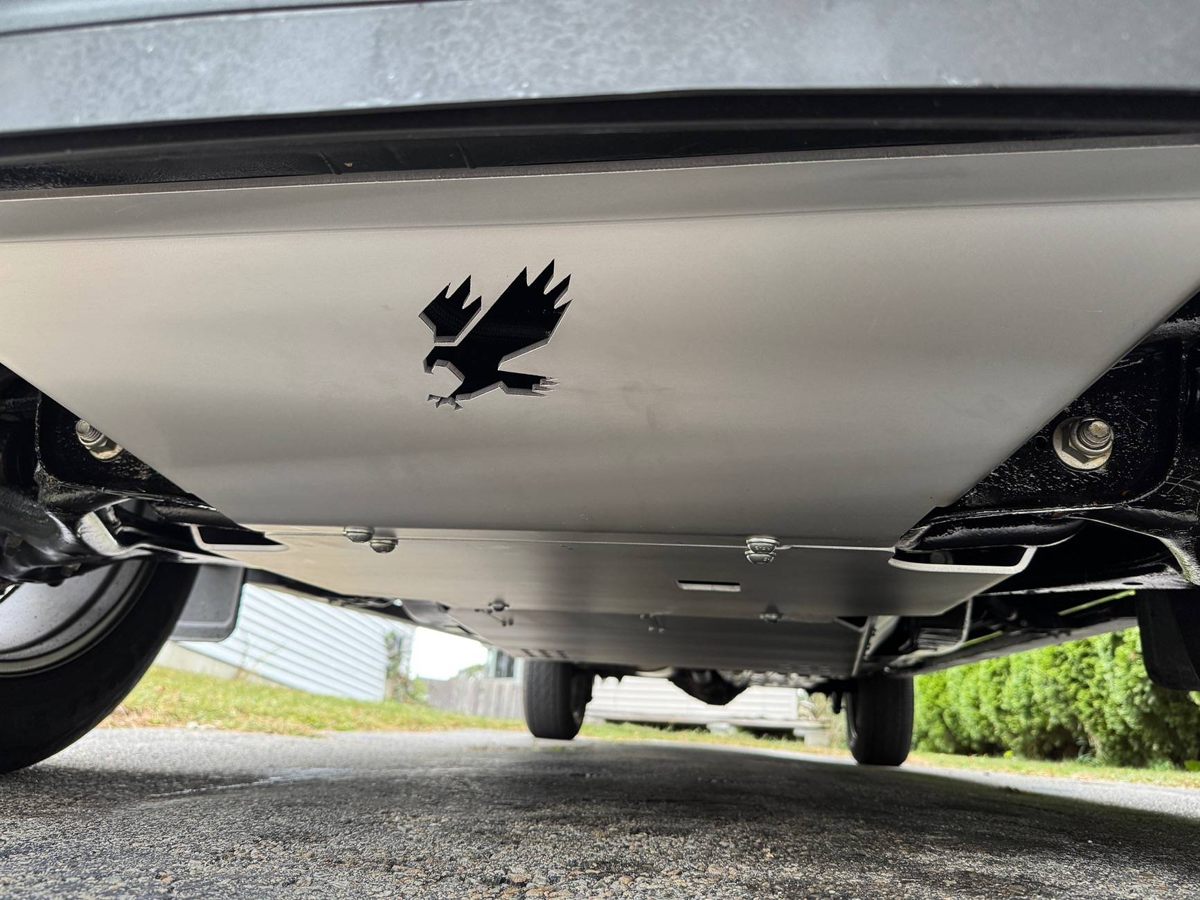

So I had a local off-road truck shop install them for me, but I’ve seen several videos where one person did it on his driveway. I had the 3 piece full Talon kit, I really like the look, weight, and rust resistance of the aluminum Talons. As far as heat, from what I gather the holes you see on them is right at the hottest parts to allow better airflow. And the link you provided is the transmission plate
Hey...that's my picture. Dang aircraft mechanics...love it
Yes this pan is a tough nut
It has deflected many road hazards
