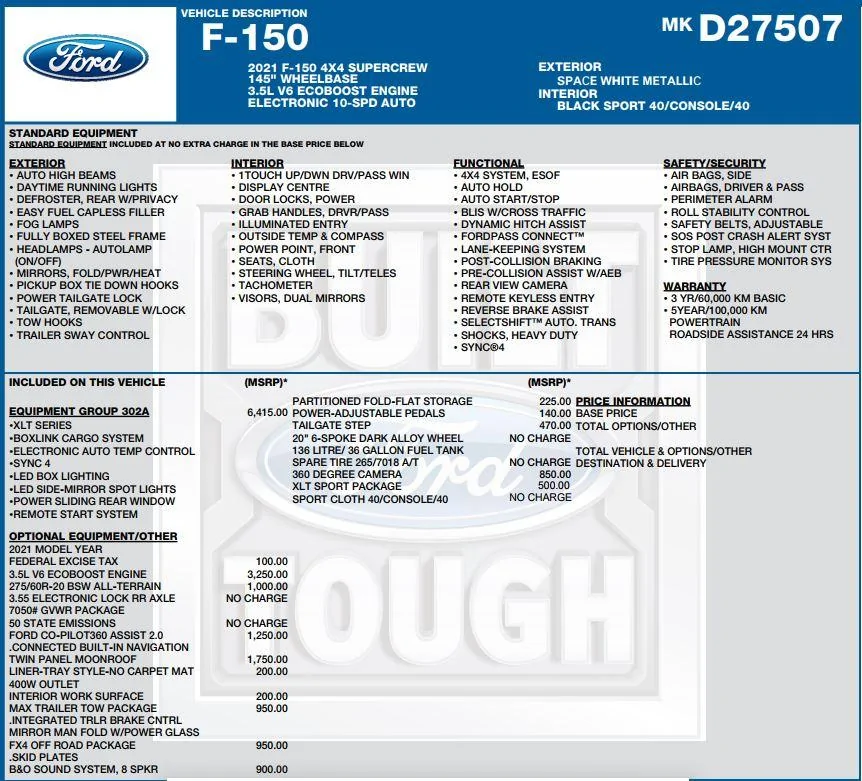

To start things off, my new rig is a 2021 Crew Cab 4x4 145” XLT 302A 3.5 EcoBoost dressed in Space White. It has a pretty extensive list of options with the only major exceptions being no PowerBoost or any sort of Pro Power Onboard system. If prices seem a little high, that's because they are in Canadian...eh ??
Ford F-150 Payload #'s WINDOWSTICKER
Per Ford's spec sheet, a 4x4 SuperCrew 145" 3.5 EcoBoost is rated at 2,100lbs of maximum payload. Listed payload on my door jamb drops this to 1,673lbs.
Ford F-150 Payload #'s 20210506_132640
