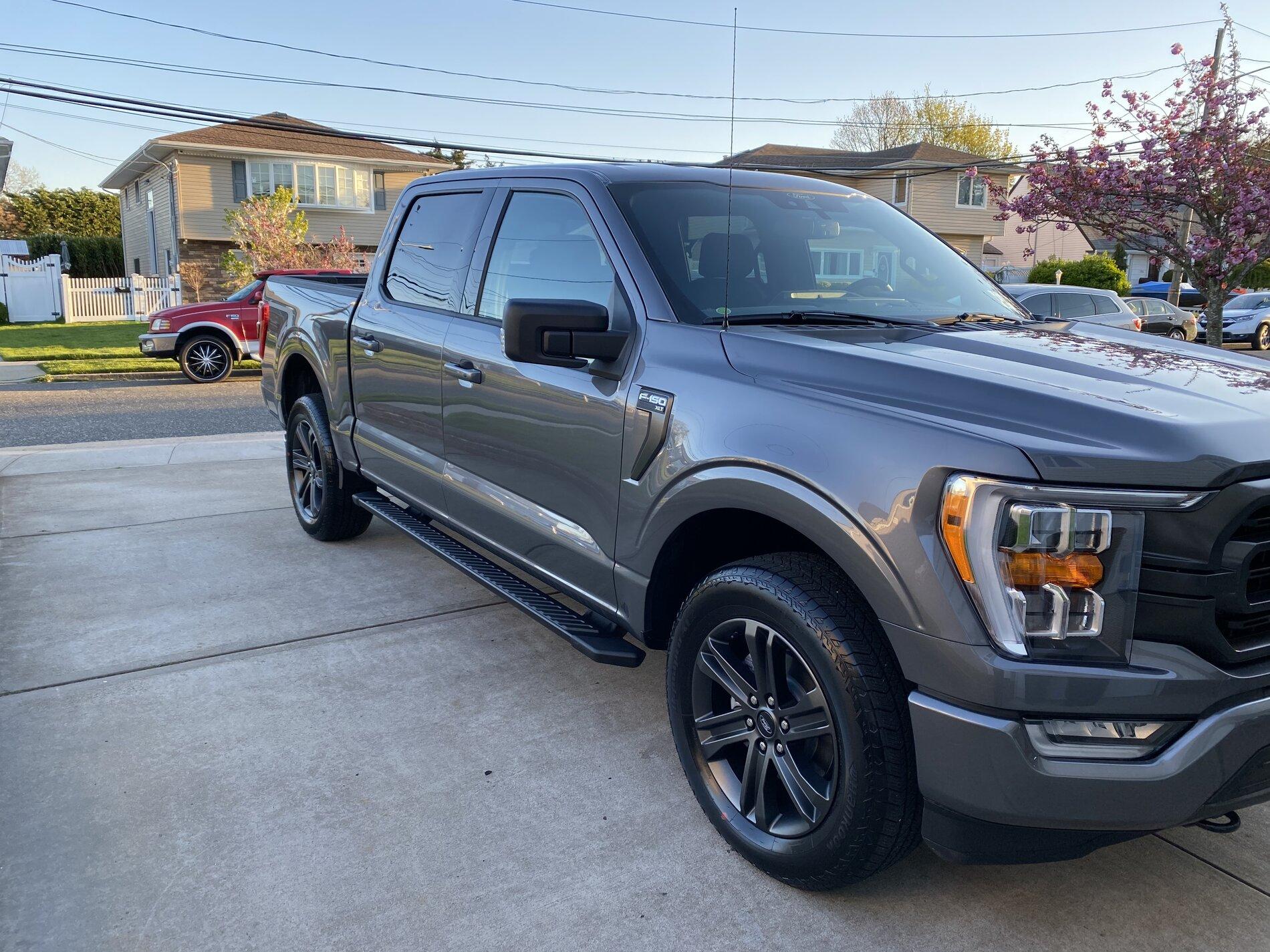

Including a pic, I have the luck of having a detailer for a friend. Pulled off the stickers, gave it a good wash and light buff, still decided on ceramic.
