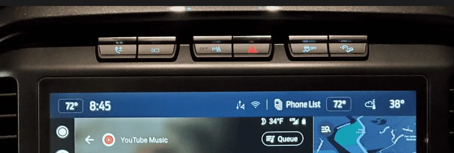

W/ 360 cams, they already automatically turn on when close to something. Of course there's the dedicated camera button above the screen to do the same. Granted if you're above 10mph or so the camera button turns on the 360s, but shows the rear cam, slower than that and the front cam is the view. Like I said though, the ultrasonics will trigger it on as well. That's not part of the self park, that's just part of the 360 system itself. You need the camera button if you don't already have it.
That really good to know, I assumed the 360 camera turn on was based on the sensors not the IPMA making that decision. Right now I have a set of mirrors, a new IPMA and rear cargo cam. I need to pick up the front emblem cam, some wire harnesses and the console trim that supports the camera button. I assume there is a few set on console trims so need to figure out how far I plan to take this project and then get the right piece.
Shouldn't be any trim, the 3 button slots above the screen can hold 2 buttons each.
As seen here (cam button is #2 in bank 1, next to PPOB / generator button)

Good catch... Some of the 2021 pictures that I saw looked like a block of switches with straighter edges. I guess I will have to see what buttons are in my truck when I get it to swap out one with a double button.
