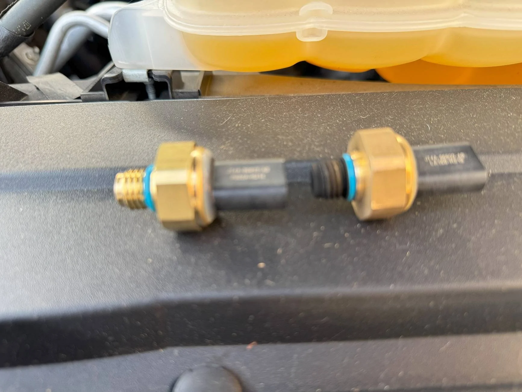

I'd like to think I'm getting quality parts since I purchase directly from a Ford dealership and purchasing OEM parts, but who knows. I'll go out and swap out the part at lunch - it only takes about 5 minutes - and snap photos of the old and new side by side.

Here are the comparisons.
Ford F-150 P0471 Error Code when in ECO mode 2
Ford F-150 P0471 Error Code when in ECO mode 3
Ford F-150 P0471 Error Code when in ECO mode 1
I used several q tips soaked in isopropyl alcohol to clean out the old one. There was a lot of carbon buildup. I tapped it on the towel and several healthy chunks of carbon came out prior to the Q-tip and alcohol wash.
I think I'll keep this one and see if it will work when the new one fails down the road.
Time to replace? Less than 5 minutes.
