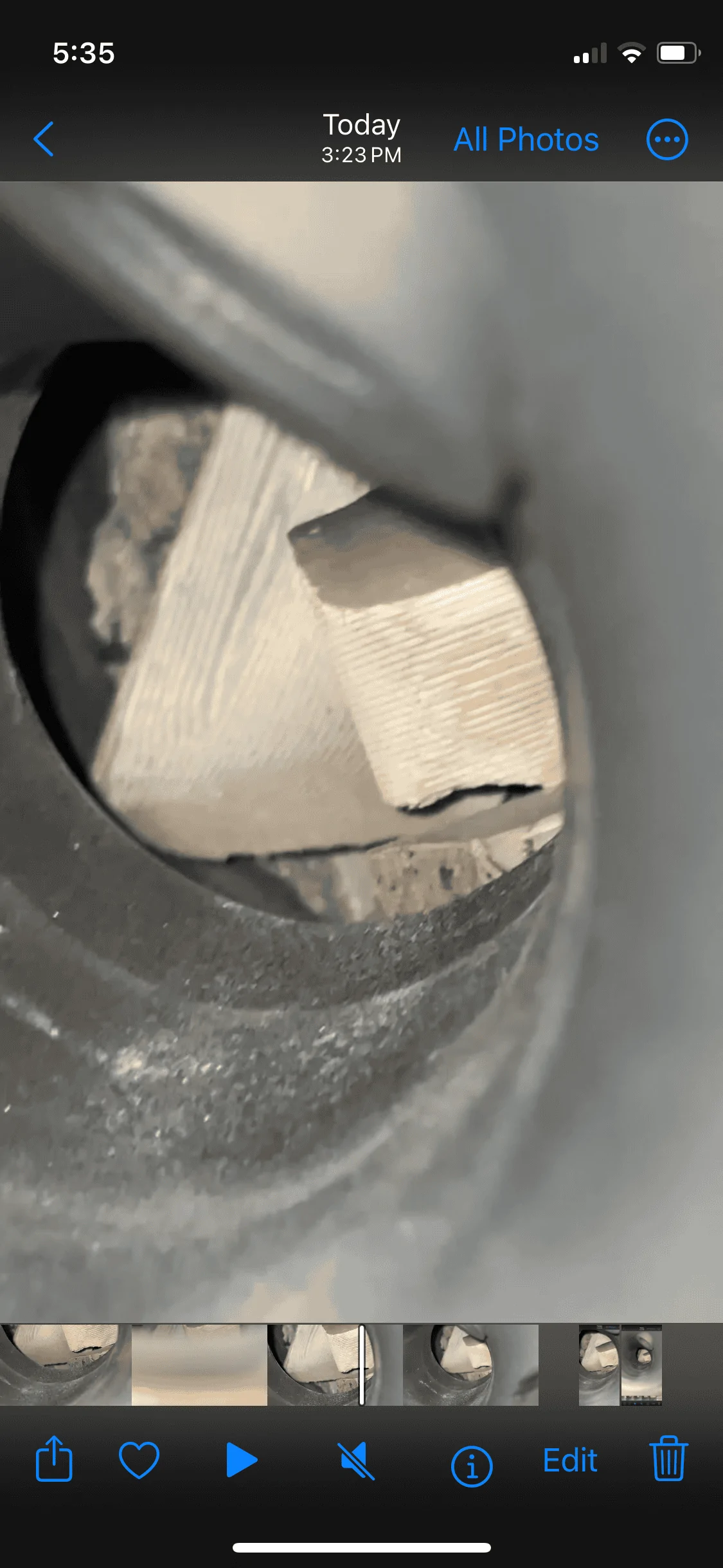

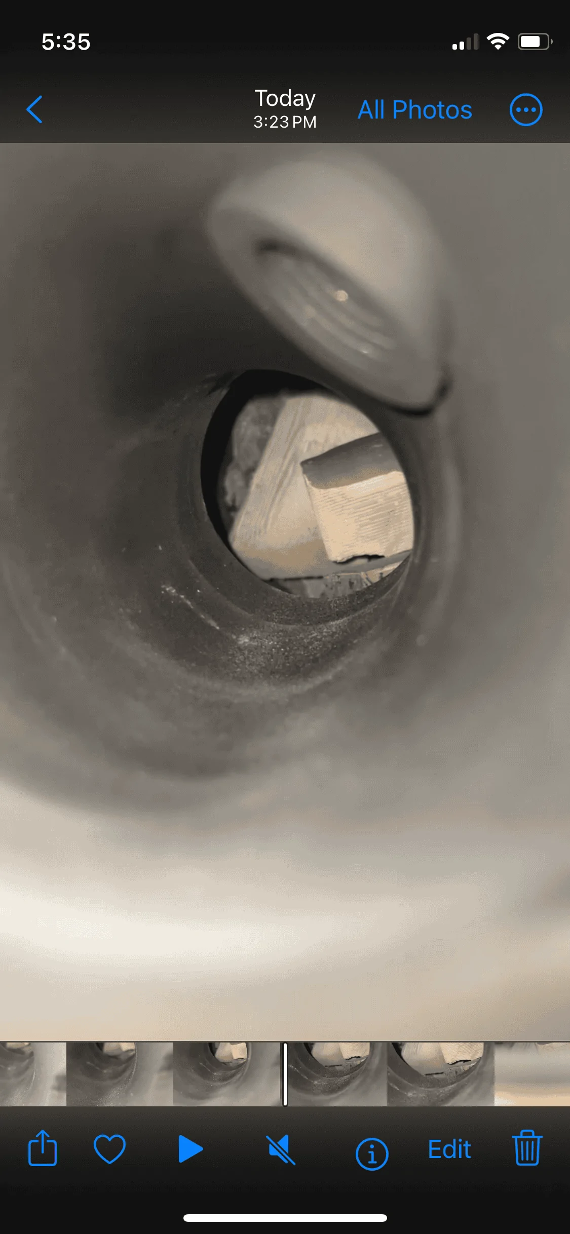

Not long back I got a check engine light with P0430 (catalytic converter efficiency threshold low) as the only code.
Took the truck to the dealership and the performed a desulfate procedure, cleared the code, and sent me on my way…
Code came back the same day. Took it back to dealer and the replaced the driver side catalytic converter.
Searching around the internet I found several examples of 2021+ trucks experiencing the same issues. All engines too not just supercharged trucks like mine. So don’t be come in here saying it is the amount of power or the blower causing the problem without references. The added power could be amplifying the problem, but it’s not the cause.
From my research I have come to two conclusions.
1: Ford cat over temperature strategy is causing thermal shock to the cats which intern is causing a crack/fault and then it eventually comes apart.
2: Ford is sourcing cats that are more likely to fail than previous generations.
Could be both…or I could be wrong.
A dude on the mustang6g forum did a lot of data gathering and that string of posts is where I got most of my info about the over temperature strategy.
Dealership let me look at the bad one when i picked up my truck. Sounded like a coffee can full of rocks when I shook it…it’s a wonder I didn’t hear it while driving.
Looks like chunks of 2x4…lol

I have heard that catalytic converter failures are much more common on supercharged 5.0 F150s because of how quickly they hit the catalyst protection limit, and how much time they spend in catalyst protection enrichment compared to a stock 5.0 F150.
I'm not sure what Roush or Whipple sets the catalyst protection lambda to, but Ford typically sets it at 0.68-0.70 (9.57-9.86 to 1 AFR). If you have any datalogs, it would be very interesting to see what limits your truck hits and what your commanded lambda is during a 1/4 mile run.

Looks like chunks of wood inside there. I have a 22 Limited duel Turbo and I am waiting on my 3'rd Cat replacement. (And I drive very easy) using 93 octane

Sounds like there's an undiagnosed issue if you're seeing repeated failures.
It's amazing the chunks didn't cause more of a restriction and back pressure. There is a fella on the mustang6g who noted he hears a rattle on the passenger side at idle and suspects the CAT.......
