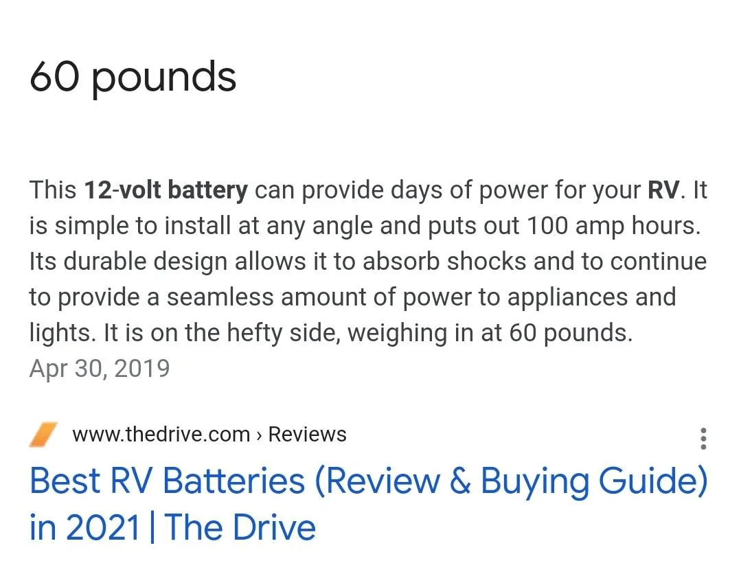

I'm not sure your statement about the batteries and propane are correct. Every listing I have seen and on my keystone the propane tanks and batteries are included so it's as from the factory. When you fill the propane tank that weight is added so 2 x 20 = 40 lbs
Not saying your wrong about your trailer specs. However most manufacturer specs do not include the tanks and battery. It even states that on their websites. My camper for example is an off grid model with 2 tanks and two batteries. The standard model has 1 of each but the same tongue weight on the site. Dealers usually add them and hide the charge in their price. My RV dealer even said they added the tanks and battery. Even walking through the lot there were just unloaded TT's I saw without tanks and batteries. 2 tanks full equal 70 lbs. 1 battery equals 60 lbs.
70 + 60 = 130lbs. Dont forget gear in the trailer
515lbs tongue weight plus 130lbs for add on equals 645lbs to drive off the dealer lot. Add in my tools and leveling blocks and rv essentials in front pass through I am around 700lbs.
I did a lot of research before buying. I had a tacoma when I bought the camper. And quickly realized it wasn't enough truck. Just upgraded to the F150.
