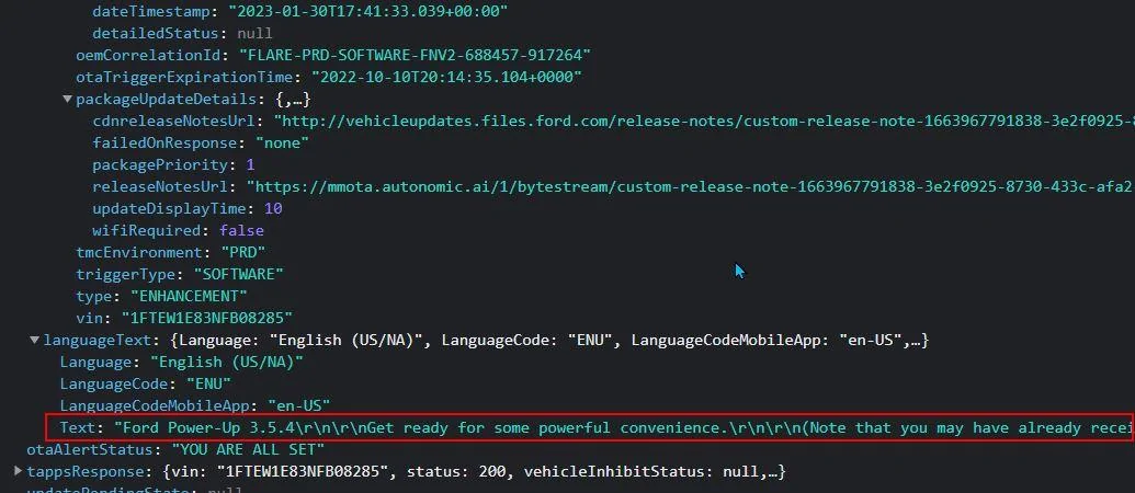

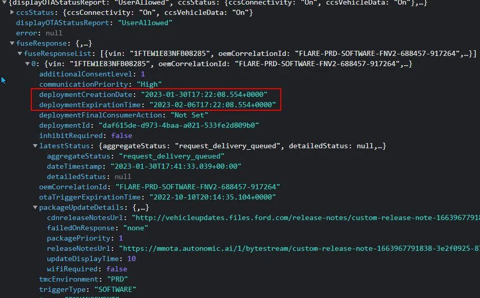

This is still working, and working well. I got 3.5.3.2 a few days ago, I've been expecting 3.5.4,since most people get it a few days later, well sure enough I checked today and it's campaign started. I'm assuming if I go park by my friend the AT&T tower, I'll come back with 3.5.4
Ford F-150 OTA Status Hidden in the Ford Website ota1
Ford F-150 OTA Status Hidden in the Ford Website ota2
Oh nice! I didn't know you could drill way down into details under fuseResponse -> fuseResponseList -> 0 -> latestStatus and see the actual current status of an OTA including date/timestamp (in GMT presumably)!
I think @rugedraw should start sending all the hundreds of VIN requests these instructions so people can stop bugging him (myself included) ?

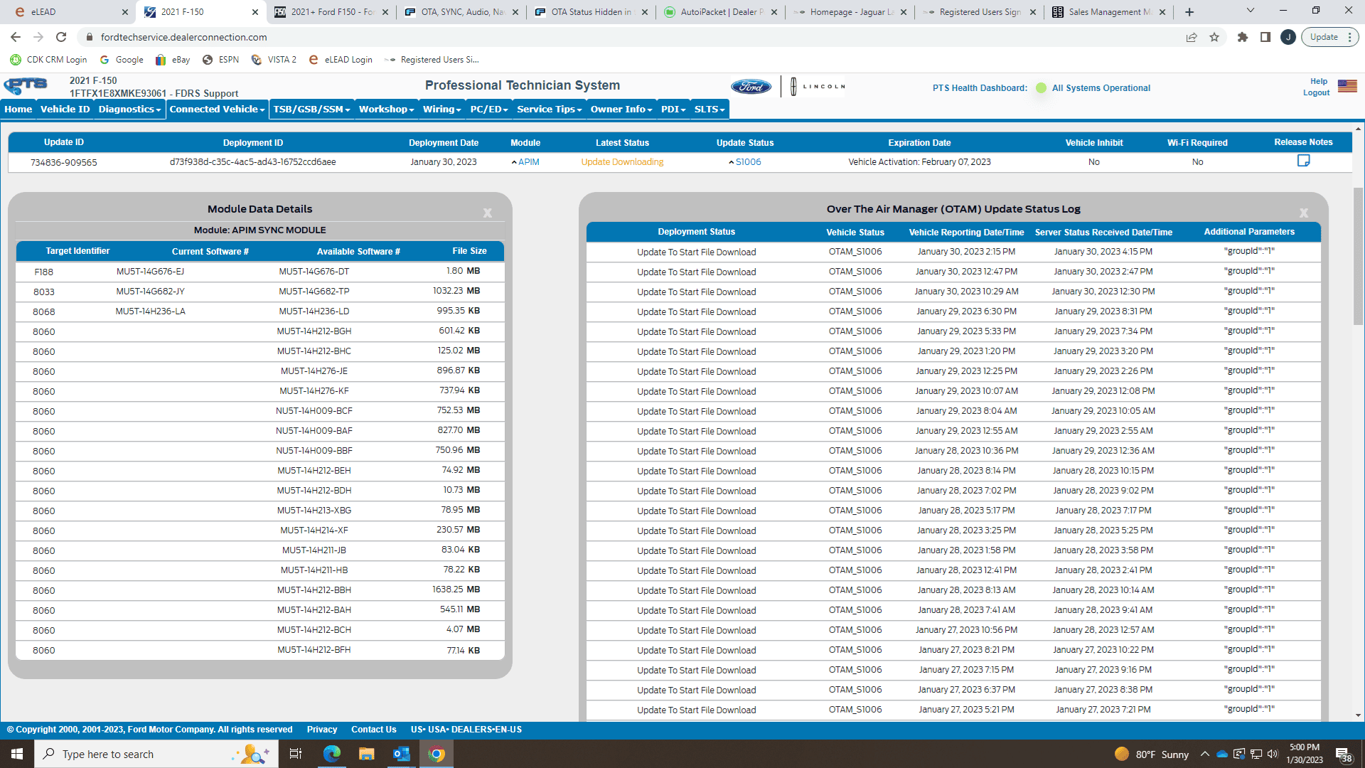

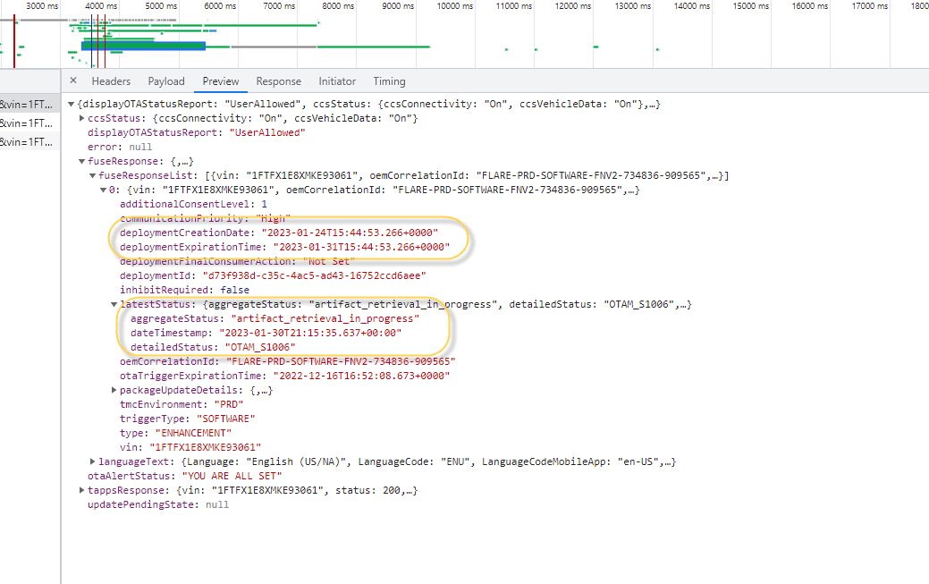

Hey @rugedraw would you mind comparing to PTS?
Ford F-150 OTA Status Hidden in the Ford Website 1675115579873
As far as I can tell, for me, the significant parts I circled above...
  • 3.5.3 OTA was first sent to me on 1-24-2023 @ 15:44 GMT (I think it's all in GMT)
  • 3.5.3 OTA expires (eg no longer available?) tomorrow, exactly 1 week from day/time the OTA was sent on 1-31-2023 @ 15:44
  • Status as of 40 minutes ago (21:15 GMT) is "artifact_retrieval_in_progress" which I'm interpreting means it's actively downloading?
1FTFX1E8XMKE93061
1FTFX1E8XMKE93061
Ford F-150 OTA Status Hidden in the Ford Website Picture14
Your truck refuses to download anything.

So for @Big Cam his aggregateStatus: "request_delivery_queued" must have meant that the OTA had been successfully downloaded in full and installation was imminent. That's what I'm after for 3.5.3... :unsure:
