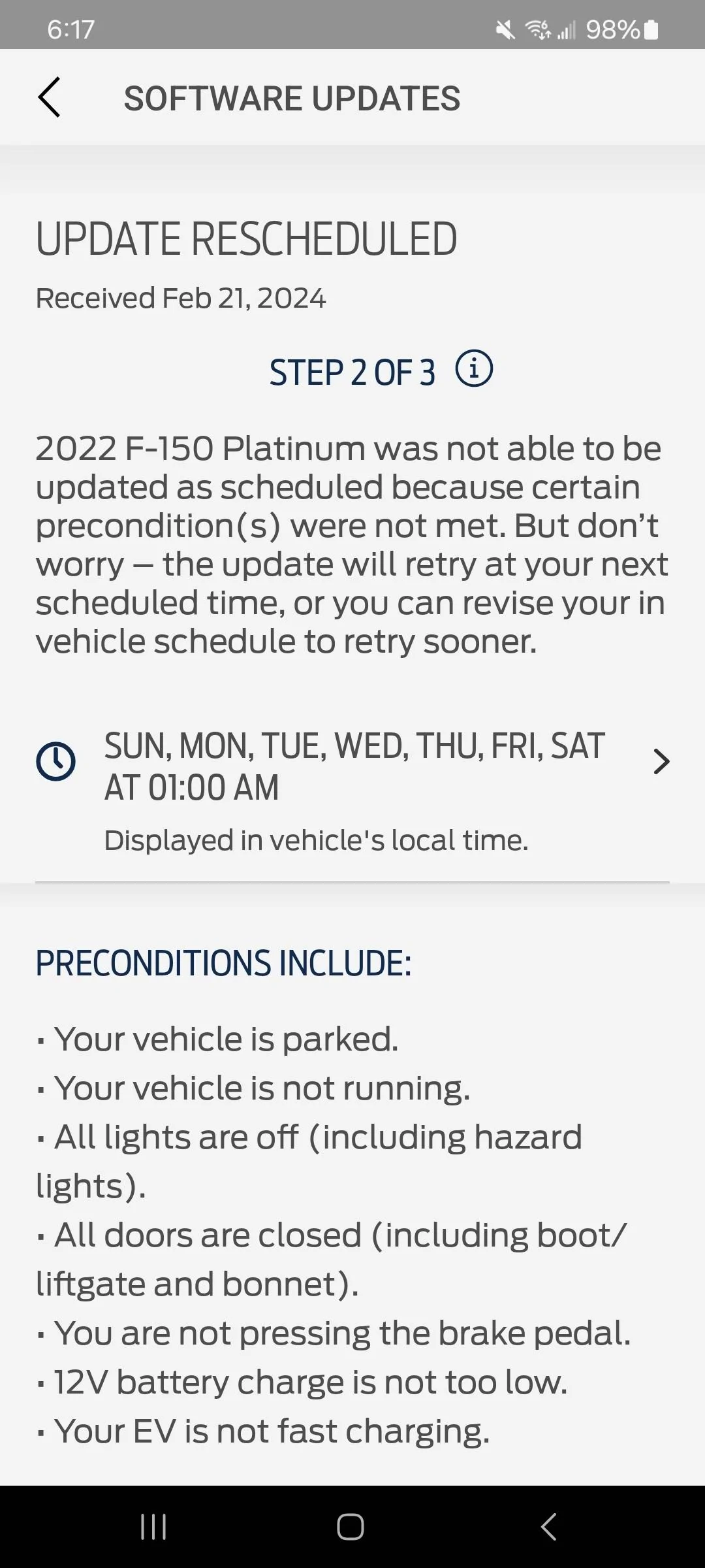

Ruged and I been working on this for a few days.
I trickle charged my battery ystrdy for 9hrs and it said FULL when I pulled it off at 9pm.
Update scheduled to happen at 1am.
This is ridiculous.

I had the exact same thing happen to me. The next morning I changed the tender setup to bypass the bms nonsense and connected directly to the negative terminal of the battery.
Update installed fine at 1am that morning.
All previous OTA installed fine.
I did exactly that. Ruged been snapshotting my battery and I am currently at 44 of 70 for battery capacity, which means my battery might need to be replaced. Im going to trickle again all day today and have him snapshot when Im done.

Here is what my snapshot looked like this morning after trickling all day, ystrdy:
- "errorCode":"InhibitRequiredHvNotQualifiedLvLow(204)"
- "totalLvBatteryCapacity":"44" (This somehow dropped from 49 after trickle charging)????
- "currentLvBatteryDataQuality":"NotWithinSpec"
- "currentLvBatteryVoltage":"13"
- "currentLvBatterySoc":"85"
- "currentLvBatteryTemperature":"14"
- "dynamicPostUpdateSocThreshold":"41"
- "estimatedTimeToActivate":"450"
- "estimatedTimeIncludingRollback":"900"
- "currentDrainRate":"9"

Well leave it to Javier (@rugedraw), we trickle charged the battery for a third time and I readjusted auto updates to happen 6 minutes after battery charge was full and it worked.
Waiting to hear what my current capacity and SoC were at the time of the update.
I already have an H7 battery and apparently it's going bad also, if\when Ford replaces it, I will request a non-FoMoCo battery and pay the diff. Sounds like all of them are :poop:.....
Update:
So here is my battery results after a "Full trickle charge"
"totalLvBatteryCapacity":"56" (max 80)
"currentLvBatterySoc":"82" (max 100)
Thanks again for your help Javi!
