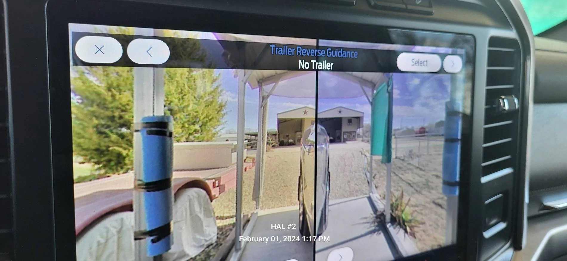

Hi Robert, can you explain what you mean when you stated you have turn signal side towing cameras when towing after your last update. thanks.
Rugedraw and Jessie and few others
Turned us on to the apim update in iirc 23 or 24 super duties that gave us camera view in center stack of trailer side when turn signal is activated.
It provides a real time view down side of truck and trailer..it gave great visibility of where the trailer is in relation to curbs, lanes etc
Funny part..is my 2008 class A bus has had that since day one..
Anyhow do a search here for trailer turn signal it's a long thread woth the guts and particulars
A few pics
Plus on camera button at speed you van select the side view from both mirror cameras even woth no trailer
Ford F-150 Ota. 10.1.0 20240201_141447
Ford F-150 Ota. 10.1.0 20240201_131732
A few pics

Hey, that's great! Do you have any idea if this is available on a 2022 F150 with 365 cameras? I have a 26" travel trailer and this would so helpful.
Should be
Mine is a 22
Look in the forscan spreadsheet thread..the codes are listed there

Did this give you side cameras when you have a trailer hooked up?
If you are talking about turn signals with a trailer you have to enable that with forscan same with the 50/50 view.

Should be
Mine is a 22
This is for turn signal while a trailer hooked up
Trailer Side View - shows corresponding camera view alongside of vehicle when turn signal is applied with trailer connected Note: requires newest 12/23 ipma updateIPMA706-01-023xxxxxxxxx--
80APIM7D0-02-03xxxxx8xxxx--adds Trailer Side View toggle under Driver Assistance
Just take a look at the spreadsheet

I have a 2022 Job 2 KR 601A PB with the 53A Trailer Tow Pkg.
I've done the BC1.4 update with FORScan, so I assume my IPMA has the update required for Trailer Side View.
I have never towed with this truck yet and have not used Pro Trailer Backup. After reviewing this tread, I'm wondering if the functionality is already there but only shows when a trailer is connected? Or - do I need to make the FORScan changes for it to work with a trailer connected. I don't have a trailer to test.
At the suggestion of @rugedraw , I made the Trailer Side View changes in FORScan. The Trailer Side View menu now shows in the Driver Assist screen, which it didn't show before. So, I should be good to go.
