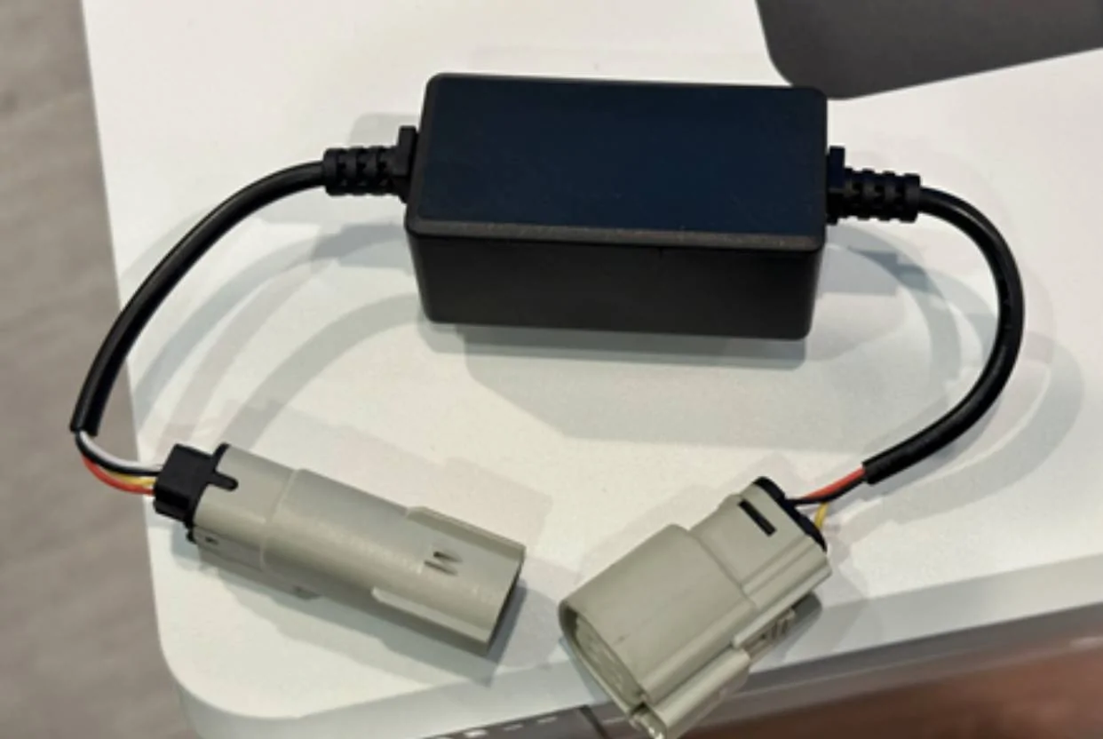

Just installed mine today on ‘21 Limited and I’m getting blis/cross traffic error and hyper flashing turn signals on dash but not at lights.
My pigtail connector is different from instructions and video as it has a third plug that has what looks like wiring colours for trailer.
Have emailed them for help.

Also just noticed another thing that someone else mentioned, no turn signals with brakes applied.

Very disappointed so far, modules fixed brake overriding turn signal but still cross and bliss warnings.
Going to contact them again.
