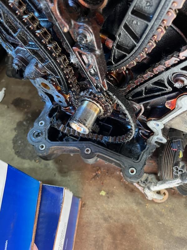

This is a 2.7 which had a belt failure at 155k miles.
Isn’t this the video from the engine that was run dry on oil? It’s cooled by oil so yes, if the sump is dry the belt will overheat and split. Doesn’t matter because you all ready ate the cams and smoked your main bearings with oil starvation. Motor was all ready junk.

This is a motor my buddy pulled at his shop, an Indy shop at that.
Need a lot more details than just a couple random pictures. We don't know the story here if it was run on low or no oil. We don't know what other abuse may have been involved.

If there was a warning or inspection method at a minimum, Id be much happier. 155k miles is a lot, but not close to the 250k mile expectation.
Admittedly a chain would have been nice, but the condition of this engine tells a story of neglect and abuse. Oil turns acidic when not changed. The dark red staining on the chains and block is from either extremely overdue oil changes or running hot and low on oil. My 5.4 3V was a light amber when I replaced the timing chains and camphasers at 162k miles. It looked nothing like the inside of this 2.7. That dark staining is extremely dirty/hot oil.

Yes it will fail with no oil to cool it, but the engine was toast anyway. I think for me age will be the driver on if I replace, 200k miles in 5 years? Probably not worried. 10 years? Ya I might think about replacing as the belt may age out.
