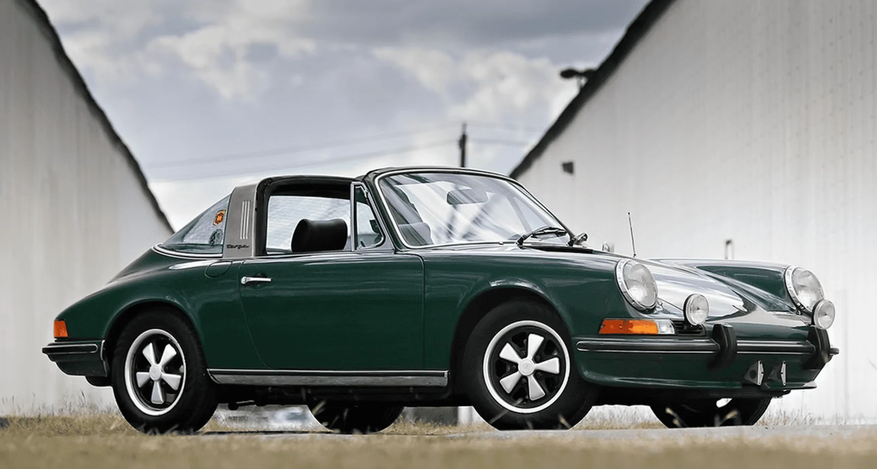

Oil pressure story: Back in high school, my friends' dad let us take his 1972 Porsche 911 Targa from Klein to New Braunfels for spring break. He gave us specific instructions on start-up that we wait until the oil pressure dropped to within a specified range before putting it in gear. He ran heavy weight oil in the air-cooled flat six. I took care of that car like Chuck Yeager and his P51. I still remember the feeling.
