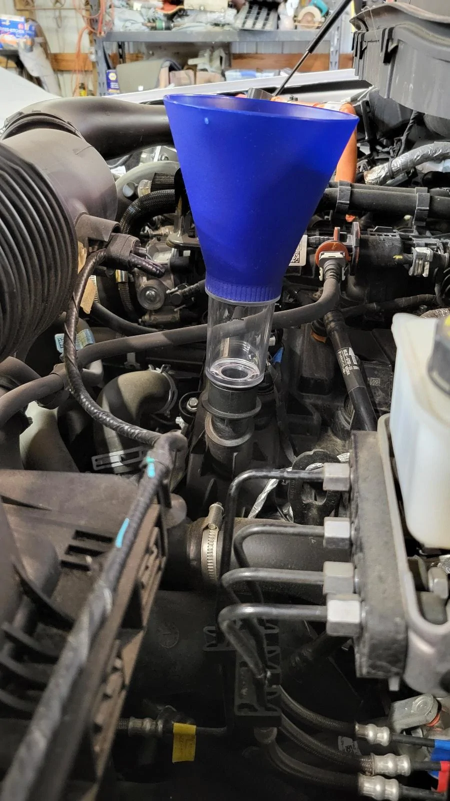

Cost very little (~$35) and only takes a few minutes. (I have it down now that I've done it 6 times and have the fumoto. Even the handsfree funnel threads to the Ford valve cover cap port)
Is this the oil and filter you recommend or there is a better one out there? How often do you change your engine oil?

I will stick with 5000(8000KM) as my truck seldom gets overworked but I see your point. I just started reading the 540 Rat blog and I think everyone should read it and thank you for sharing! By the way, I just ordered the funnel you are using!
