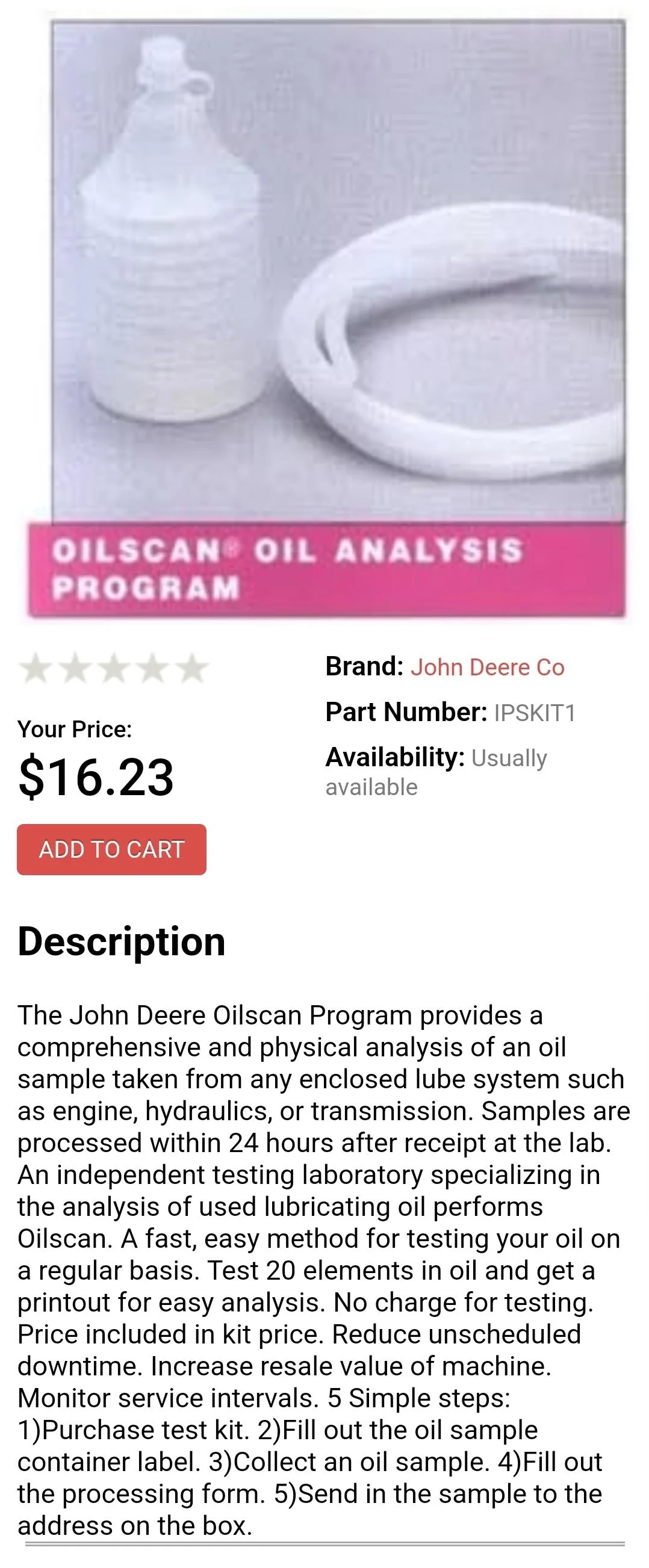

John Deere has an Oilscan program I used when i worked there. Your local dealer should have the kits in stock. I don't know how it is now, but turn around time was quick a couple years ago.
