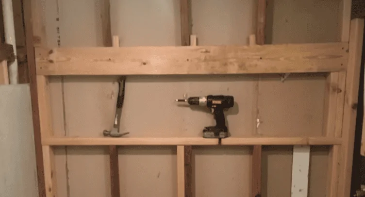

Wow that is tight. Should be easy to get an accurate measurement on a real truck. Use a piece of string and tie a nut or washer to it (plumb bob or plummet), hang it from the forward and rearward most part, mark the ground with a piece of chalk and use a measuring tape to measure the distance between the two marks = accurate front to rear measurement.
I have a 6.5' box SuperCrew, so I can't get the information you requested.
You do have 3 weeks to have a contractor make a clearance space in your garage. Cut-out a section of the wall : add a header to support the wall above the cut-out. This will gain you an addition inch, to inch and a half for a 2x4 construction wall. More if you have a 2x6 wall.

This was exactly my plan, hence the request to see if it’s needed.
