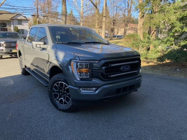

nope, I basically made my own. FYI, the 2021 grill interior space is now smaller than previous and wont fit light bars. I made my own back brace and mounted light bars on the front of the grill.
Ford F-150 Off-road Lighting Mounts image0
Ford F-150 Off-road Lighting Mounts image1
Ford F-150 Off-road Lighting Mounts image4

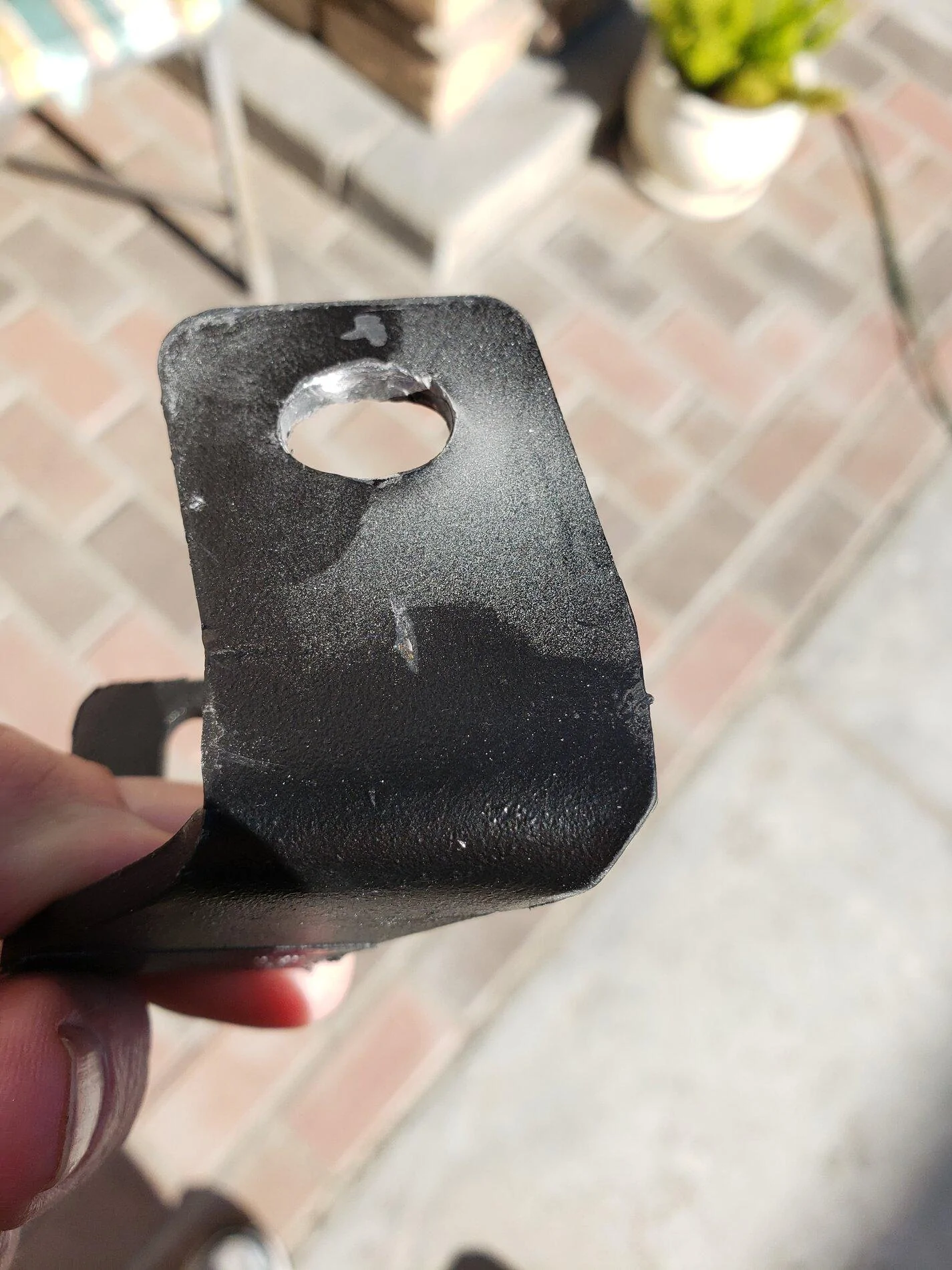

I got old style amazon 2 bolt mount version by Dasen for $23 and had to dremel it a bit to get light base to go through and installed BDs universal kit.
Passenger is behind antenna but oh well, works. Seems some of the new ones are too.
Came out nice, good and solid, will test next weekend on a desert overnight.
Unless I get the new ZROADZ mounts before that.

If I’m seeing this correctly, your mounts are a couple pieces of bar stock drilled out, and the bolts from the light bar brackets run through the thicker parts of the grill? How stable is the mounting; do you get any shake or bounce from the lights when going down the road?
That's correct, I used bar stock as you mentioned. The mounts are pretty stable as I had it on the truck for about a year with zero issues. I would still like to see if there's an aftermarket grill to relocate the lights inside. Maybe the aftermarket Raptor grill would work
