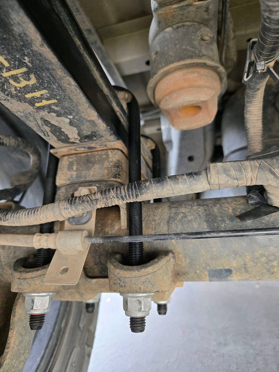

I was just looking under my truck and noticed that the driver's side leaf spring is off-centered. The passenger side is fine so I just wanted to know if that's normal? I guess I could loosen up the u-bolts, center it and fasten them back down, but I guess I want to know is this a symptom of something else that I should be concerned about?

My 22 XLT is the same. I noticed that when it was new and I was installing my Bilstein shocks. I checked the ubolts to be sure they were tight, which they were and nearly 40k miles later nothing has changed or happened. Unlikely that it will become a problem. Just more signs of the overall lack of quality control with Ford and their suppliers.

Same here. 2021, Kansa City, was like that 3 ish years ago. Now it looks like its about to fall off. So I'm looking to re align, unload, loosen hammer/C Clamp it straight? re torque. Saw some posts about loose U bolts that you can re torque on F150's. Saw a few posts about Rangers having same issue. "fanning" ?, one roll pin, one center bolt? Saw one guy did it himself. Need to be sure pin is still intact I think. I think our pins are part of the block material if you have one of the 2 or 3 different blocks. No block (non 4x4), 1" , 1.5" or 2" for Tremor I think. I may get Ford dealer to look at it. But I don't really trust them to respect anything under warranty or fix anything correctly, or ... sometimes.... LOL Maybe good time to put 2 or 3" blocks in too.
Yours look like they will be ok to me. I'd find torque spec and check/set torque on U bolts? Then just keep an eye on them. But I'm no expert.

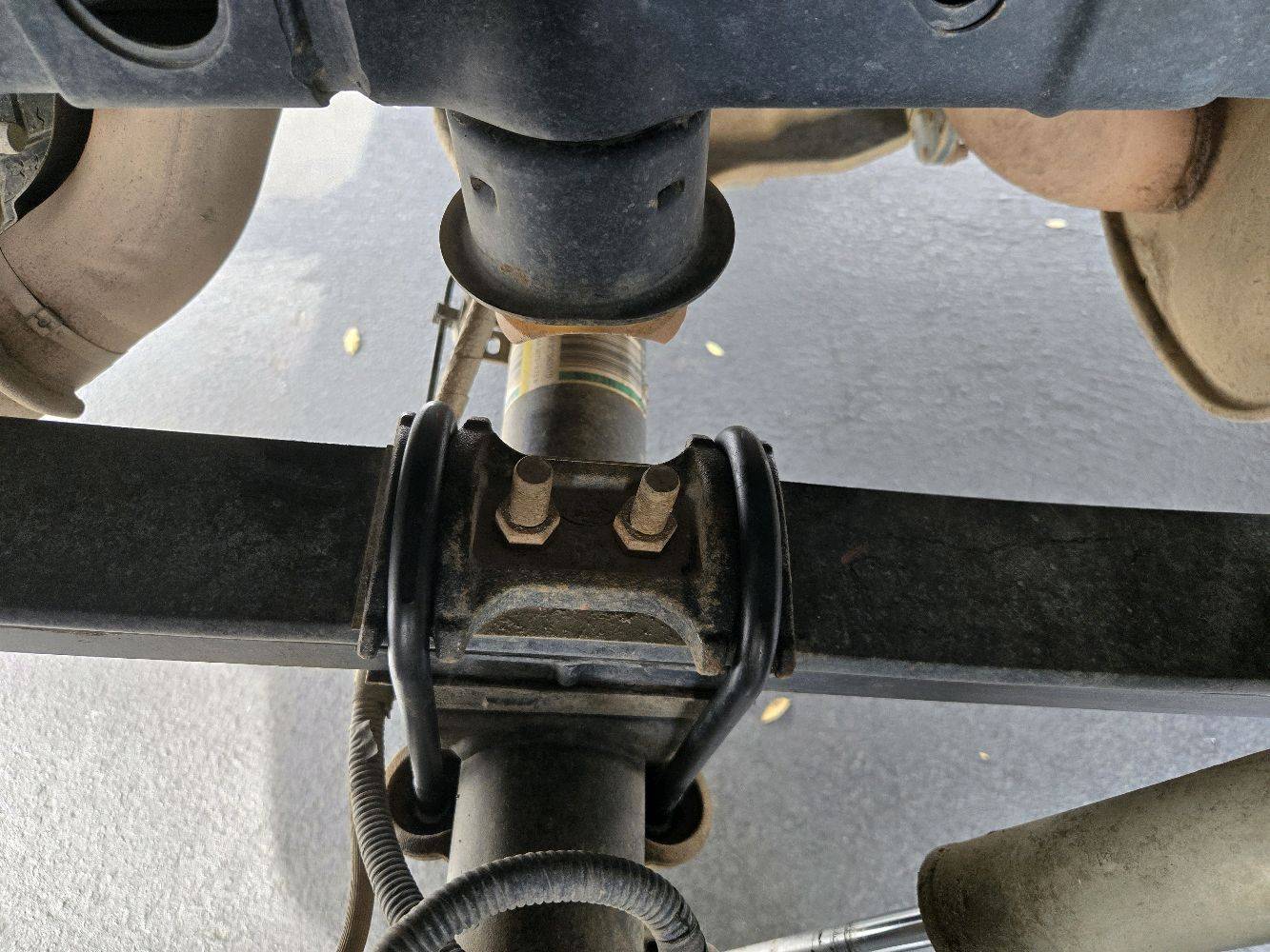

mine is this way and i failed to fix it when i had it apart installing a lift.. i thought i induced this.
my alignment is off a third of a degree in the rear due to it.

Would think the only way the lower spring could shift that far is with a sheared alignment pin. It’s rare for a spring pack to have two, usually spring straps are used for alignment.

It definitely has 2 pins but when I had mine off I noticed they weren’t a tight fit so could see the spring move slightly if the ubolts aren’t torqued properly.
