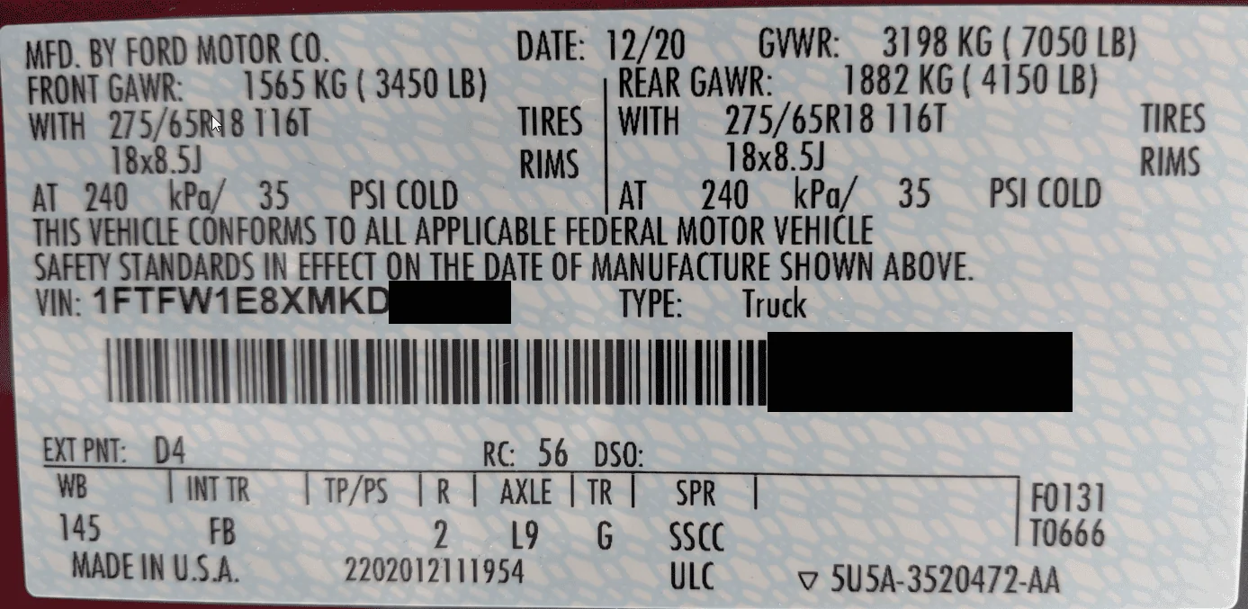

I have an 2021 F150 XLT w/ max tow package, 7050#GVWR, 302A package. Do not have off-road/FX4 package. I too had a stiff ride out of the gate but followed advice on this forum and lowered air psi from 42 -> 35psi and had very good results. Takes enough edge off for a smoother ride. I also came from a 2004 Expedition so probably not used to the stiffer ride of a pickup.
Ford F-150 Extra leaf spring for max tow? Snag_687751c
Ford F-150 Extra leaf spring for max tow? Snag_6877bfa8

@gowestyoungman You forgot to blur your vin on the door sticker. Just sayin'

The 3 leaf spring comes with the 4150# rated rear axle. To get that axle you need ANY powerboost, or a max tow. 3800# and less are 2 leaf springs.

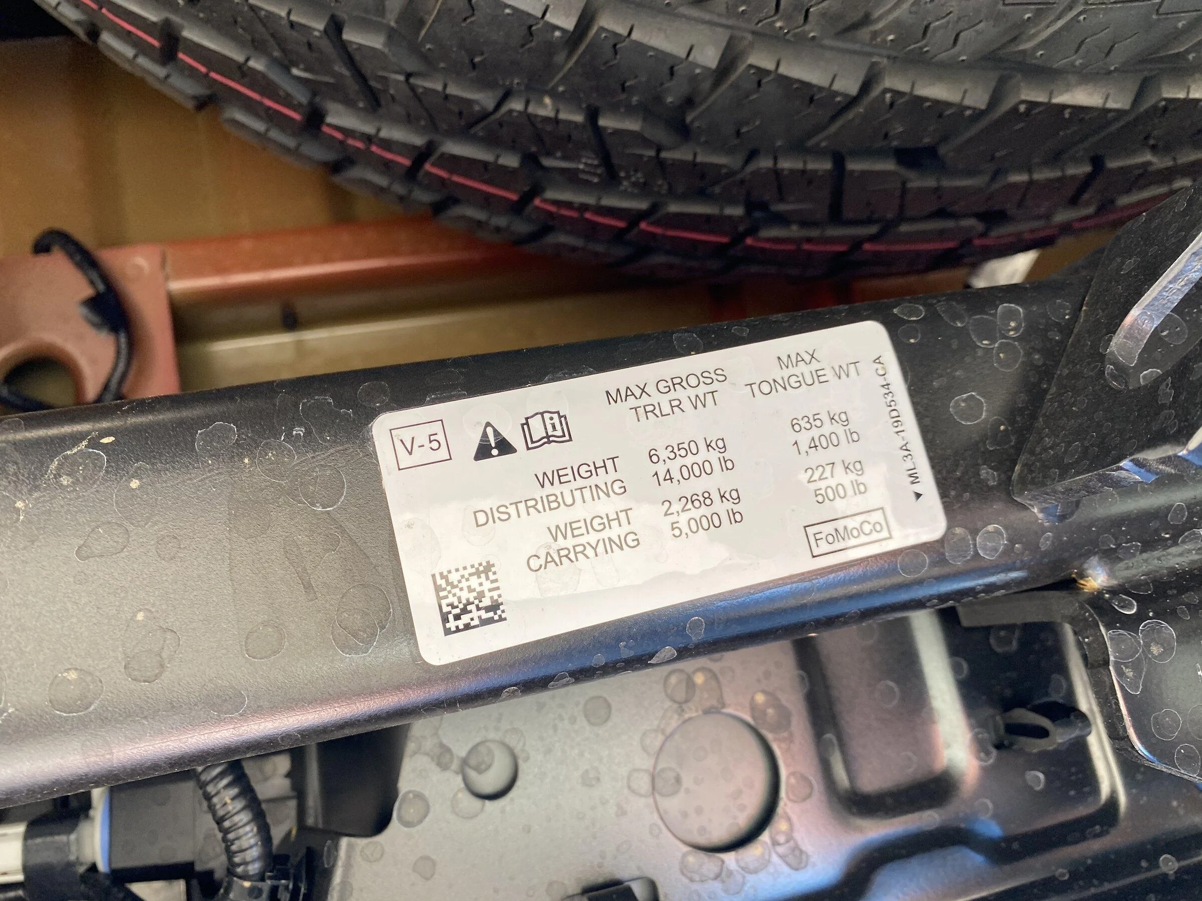

Before ordering my truck, I test drove the max tow vs non max tow (with all the same options) xlt trucks back-to-back on the same road. The max tow had a much stiffer ride and you could feel more bumps and the regular tow with the 2 leafs rode much smoother. Payload was almost the same so they will have similar limitations with pulling assuming you stay with payload limits and 10-12% tongue weight. All the max tow had 3 leafs on the lot and regular tow had 2 leafs when I was looking. The hitches were 11,600 for the non max and 14,000 for the max.
Ford F-150 Extra leaf spring for max tow? IMG_5837
Ford F-150 Extra leaf spring for max tow? IMG_5860
Ford F-150 Extra leaf spring for max tow? IMG_5861
