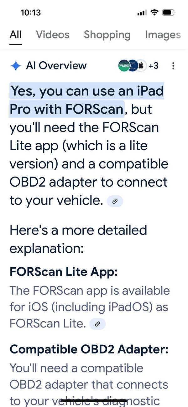

Here you go. You should be able to use iPad. Not sure with the app if there’s a limitation on what you can do.

Thanks for the replies everyone. I forgot Forscan is Ford only. I’m doing my research now on scanners. I might just retract the EPB manually with a battery and jumpers but need to do my research before I jump into that.n
