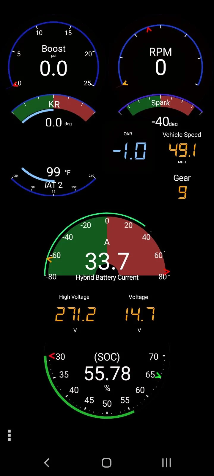

I'm a flatlander, so no downhill/uphill EV data. However, if ambients are warm enough and the trucks reached adequate operating temperature for the various fluids onboard, I have EV cruising at 50mph cruising daily. (it's a stretch of rural road with 45mph posted)
Of course the SOC for the HV battery has to be in the high 50's or low 60's SOC. And it will last for however long it takes to deplete down to 42-44% SOC. It's not quite a minute.
I screen shot'd such a moment
Notice the Amp draw to sustain 49.1 mph (Speedometer indicated numerical 50)
Regenerative braking can INPUT double that amperage!
That's why I believe these pids can TEACH you how to best manage the Hybrid system, based on the real time circumstances, which allows you to enjoy the trucks ability to be efficient, but without necessarily hypermiling and missing out on the ~600ftlbs of torque when the occasion calls for it. :)

I have had EV mode kick in at 59mph. I know that specifically because I was seeing if I could get it at 60mph cruise. The SOC was in the mid 60% and the Powerboost logic was refusing to increase it further from ICE. I reduced ACC by 1mph and it triggered EV.
Anecdotal, of course, but it makes me wonder what the cutoff speed is for flat land EV?
