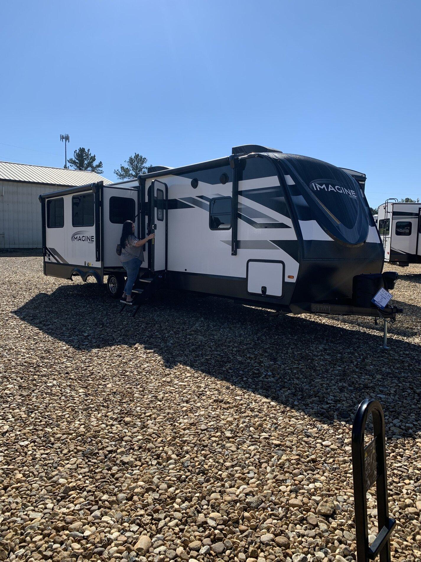

Picking up my new TT Thursday. 34 foot tongue to rear. 7400 lbs unloaded (includes 2 tanks and battery) GVWR 8995 lbs, hitch 750 lbs. my payload is 1486 but Ford said I can add 300 lbs for 2 passengers And it won’t count against my payload. 3.5 eco boost max tow Platinum

BTW, I have a Primetime Lacrosse, and from that angle, it looks identical to yours. I bet they were built in the same factory. Is that a Forest River brand?
Grand Design imagine 2970rl
