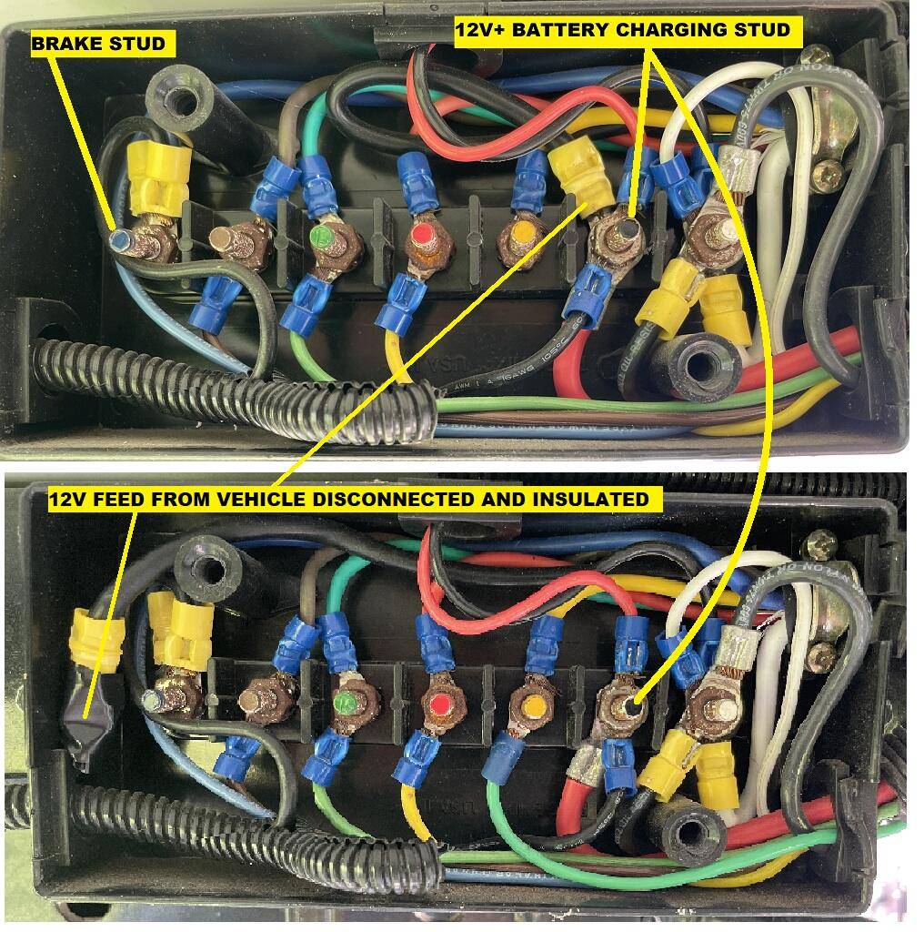

So far, I've found my 800W PV array / Victron MPPT 150/60 -TR Charge Controller keeps my 400Ah LiFePO4 battery happy without any charging from the vehicle (I disconnected the battery charge wire in the 7-pin umbilical cord junction box of my trailer, altering nothing on the truck because I have another trailer with a regular AGM battery and no solar).
Ford F-150 Charging Travel Trailer Lithium batteries question 2022 5-0 JUNCTION BOX EBRAKE
I very rarely use shore power when camping, relying on solar and a Xantrex Freedom XC 2000 all-in-one inverter/converter/TS for my relatively modest AC and DC power needs. The Xantrex is analogous to a Victron Multiplus with fewer bells-and-whistles that I don't need.
I have a master disconnect which allows total isolation of the battery from all trailer charging and loads when parked for an extended period - the SOC drop of the isolated LiFePO4 is de minimis when sitting unused for even very extended periods. I have the trailer always connected to 30A shore power at the house when sitting this way to provide AC and DC juice for lights, refrigeration, and heating via the Xantrex whenever wanted.
I monitor my battery condition with a Victron BMV-712 / shunt.
This works well for my use-habits, but YMMV.

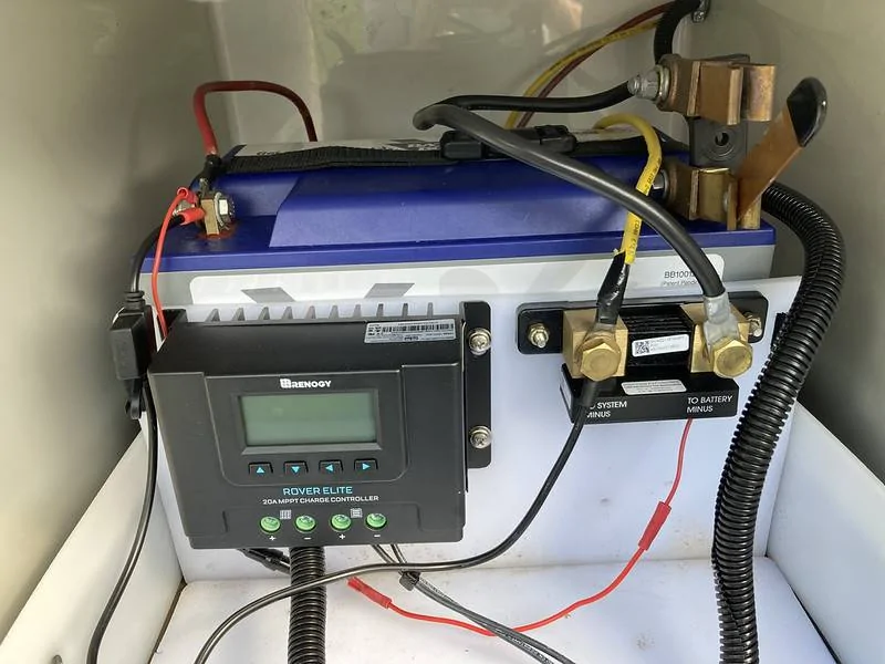

Many folks use a DC to DC charger to charge their Lithium battery.
When I installed a single BattleBorn 100AH battery in our camper replacing two group 27 lead acid batteries, BattleBorn told me it was OK to let the 7 pin charge cable charge the battery while in transit for our installation, I recommend talking to the battery manufacturer.
If
the Tow Vehicle's 7 pin charge pin remains hot with the TV ignition in the off position, it is possible to run the TV battery down with something operating in the camper with the TV 7 pin connected. We have a Victron BlueTooth shunt installed to monitor the battery and the TV charged the Lithium battery at about 3 amps.
Here's our single BattleBorn 100AH Lithium installed with water resistant Victron BlueTooth Shunt and Renogy solar controller with Lithium charging setting for our Renogy Solar Suitcase panel.
