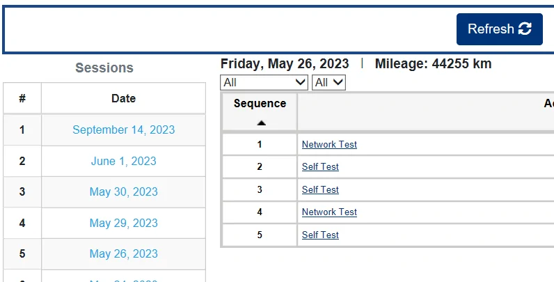

(@rugedraw can you check 1FTEW1EP7MFB56099 APIM version history, thanks)
May 26 when connected up it reported mileage of 27,499

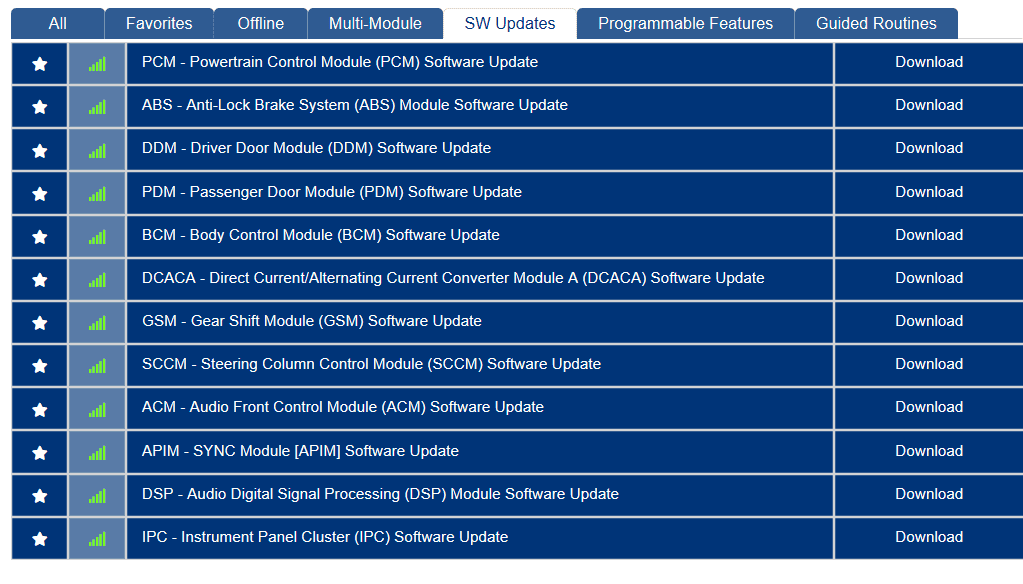

On June 1st they did some more FSA/TSB work including a couple software updates

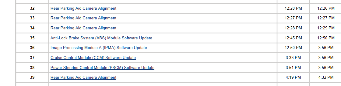

14-SEP it had gained a couple miles and had the rear BLISS radars PMI'd along with the cruise radar. They also aligned the lane centering and 360 cams.

In summary they've done a few software updates and its initial mileage was recorded before they started off on their update spree. Which based on the results, is laughable as you've still got loads of updates (see below) including additional versions of updates they supposedly did. This appears to be one of those trucks that were lost in update purgatory (my speculation). I suspect the dealer may do some of these updates to try and resolve the issue while ignoring others. Not all is lost though, I know someone an hr north of you that has the means to rectify the other updates. Depending on how far back some of the updates are (APIM), the dealer would try to get $800+ out of you to do them (get as many free updates as possible, pay for none) as it could take many hours if it's as old as suspected. Someone w/ the other software can check your status (pinged someone above).

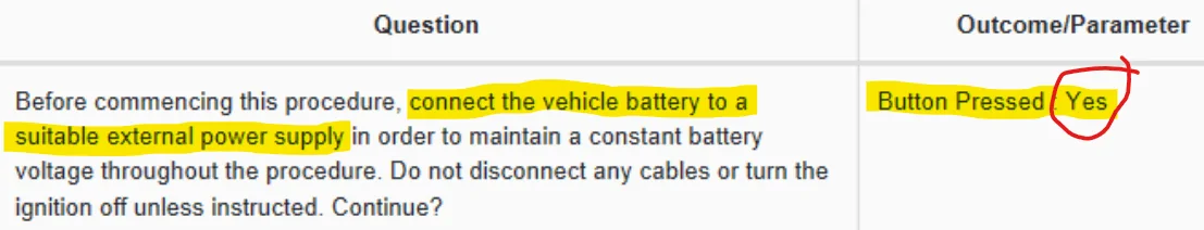

I suspect since they were playing with the BMS resetting, they didn't have it connected to power and it went to sleep mid-update (shitty work ethic). That's my theory as to how things were botched. It was probably the IPMA update where the truck's batt died and screwed it all up. It's fixable, just looks like the dealer's service dept is incompetent (the one you got it from). Letting the battery die in updates due to not connecting to power is unacceptable, especially with this prompt..

This truck is on Sync 22294 and got OTA's in May and June of this year before the dealer touched it. Based on vehicle history, this was not a truck that got stuck in OTA limbo as there is no indication of an APIM replacement or manual APIM updates done at any time. It has a build date of 4/27/2021, which is very early job 1 build that seems to have updated itself on its own for the most part.
The IPMA update they did on 6/1 was successful. They started at 12:51pm and it finished at 3:32pm, so a bit under 3 hours which makes sense since they use a VCM and not a Mongoose, so it writes faster. This truck got the 3.x.x updates around the time that Ford started pushing those updates out and skipping over trucks missing the 2.x.x updates, which would explain why he still is showing IPMA updates after they updated his IPMA.
As far as whatever they did on 9/14, the tech notes are not in PTS yet so I have no way of seeing what they were trying to accomplish on that day. PTS is not showing any DTC's since he got it a few days ago relevant to the issue. On that day, they PMI'd some module that is not specified in vehicle history and performed an IPMA calibration procedure after which says was complete in 3 minutes which seems fast, but not impossible. It seems like the replaced the IMPA, but can't say for sure until PTS reflects whatever they did.
With all of that said, the mileage is displayed on the IPC, so the I'd say the IPMA has nothing to do with this. I'd have to pull the as-build data and make sure the BCM has the right values for the 3.55 gears his truck supposed to have. However, if those values were off, it means he would be driving at 60 mph and hi speedo is saying he is going 20 mph in order for the truck to be recording 1/3 of the miles he is driving, so that can't be it.
