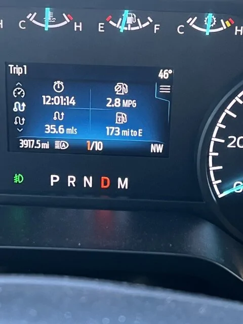

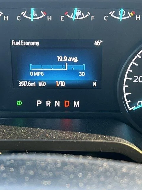

3) Trip Odometer - Randomly stops working; Displays EXTREMELY incorrect MPG and EXTREMELY incorrect miles driven (see pictures); I suspect this is caused or related to #4 Reboot issue below. It really sucks, because I like to keep track of my MPG and miles driven. To clarify, I reset both Fuel Economy and Trip 1 with each fill-up. I probably had driven around 150 - 200 miles (guess) since the last fill up when these pictures were taken.
4) Infotainment Freezes/Reboots occasionally at Startup - This issue happened A LOT the first week I had the truck. I chocked it up to being new and largely, it has resolved itself. But I still have a random Freeze then Reboot on startup and I really think this causes or is related to #3 above.
