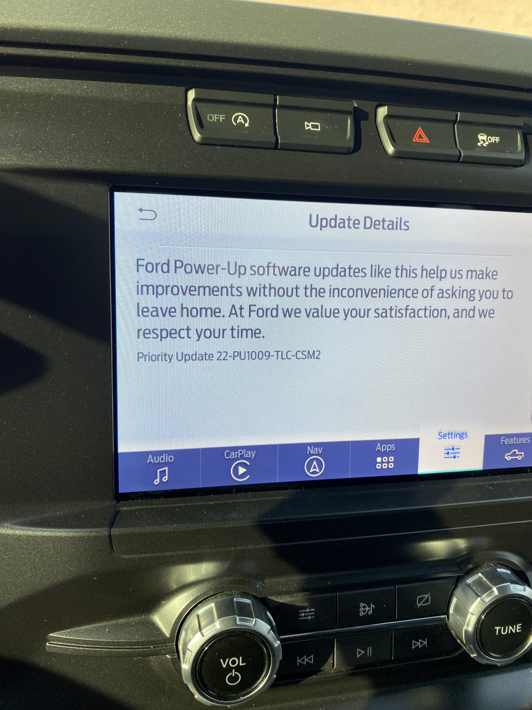

Here is the bottom of that update screen.
It says not completed. Even through the auto updates were turned on, the time portion was not set. I set it last night. How long does it normally take for that to happen?
sorry / this is all new to me. I’ve never had a vehicle auto update! Pretty cool.

Thank you to whoever looks this stuff up. This was the response from the VIN thread:
Truck is missing the 6.x.x updates, but your issue doesn't sound like a missing update problem. Maybe the button itself is messed up? Have you tried the dealer yet?
Will the Truck get the 6.x.x updates on its own over time?

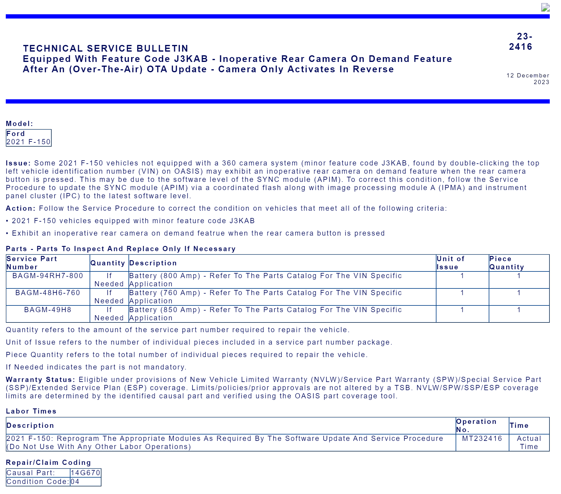

If yours is an early 2021 build without the 360 degree camera there is a technical service bulletin that deals with this. A software update is required. I had all the exact same symptoms you described on a used 2021 Lariat I recently brought and was able to get the dealer to do the TSB under warranty as I still had a week or so left on the Ford bumper to bumper warranty.
I thought this was an OTA issue.
They are out of warranty so would be better off DIY with FDRS at home.
