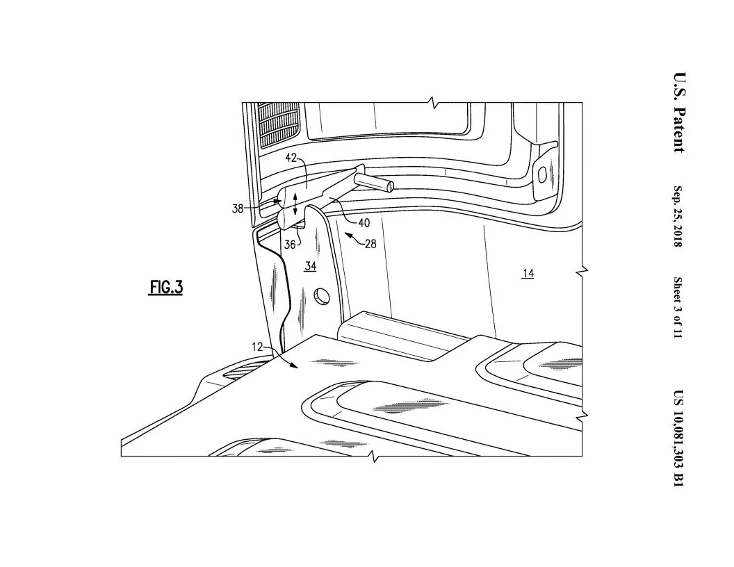

Initially filed in 2018 and assigned US Patent number 10,081,303 B1, Ford’s filing is entitled “Full Size Tailgate Step.” It mentions a latch mechanism with “rails to allow the tailgate to pivot,” and that the user would “selectively pivot the tailgate between a closed position, a tailgate deployed position, and a step position.”

Does a "step position" means a middle angled position like this?
Ford F-150 New tailgate pivot feature for new F150? 0 (1)_page_17
If so, it'd allow an easy way to haul longer than bed-length items.

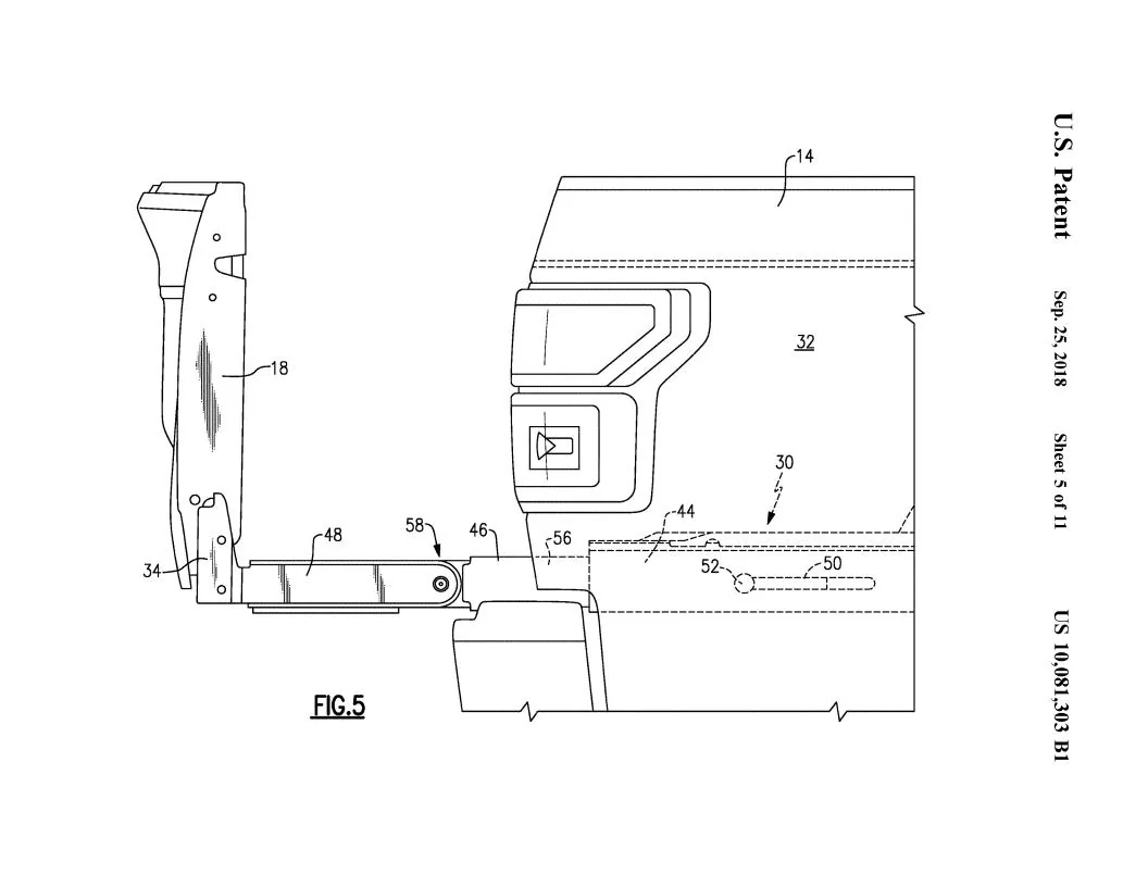

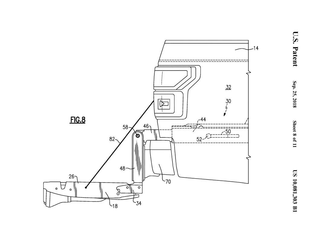

No. look at the picture in the article. It is a step similar to the one on the GMC's but it appears to show a slide built into the bed so the pivot point moves toward the rear. Look at #50 and #52 in the drawing.

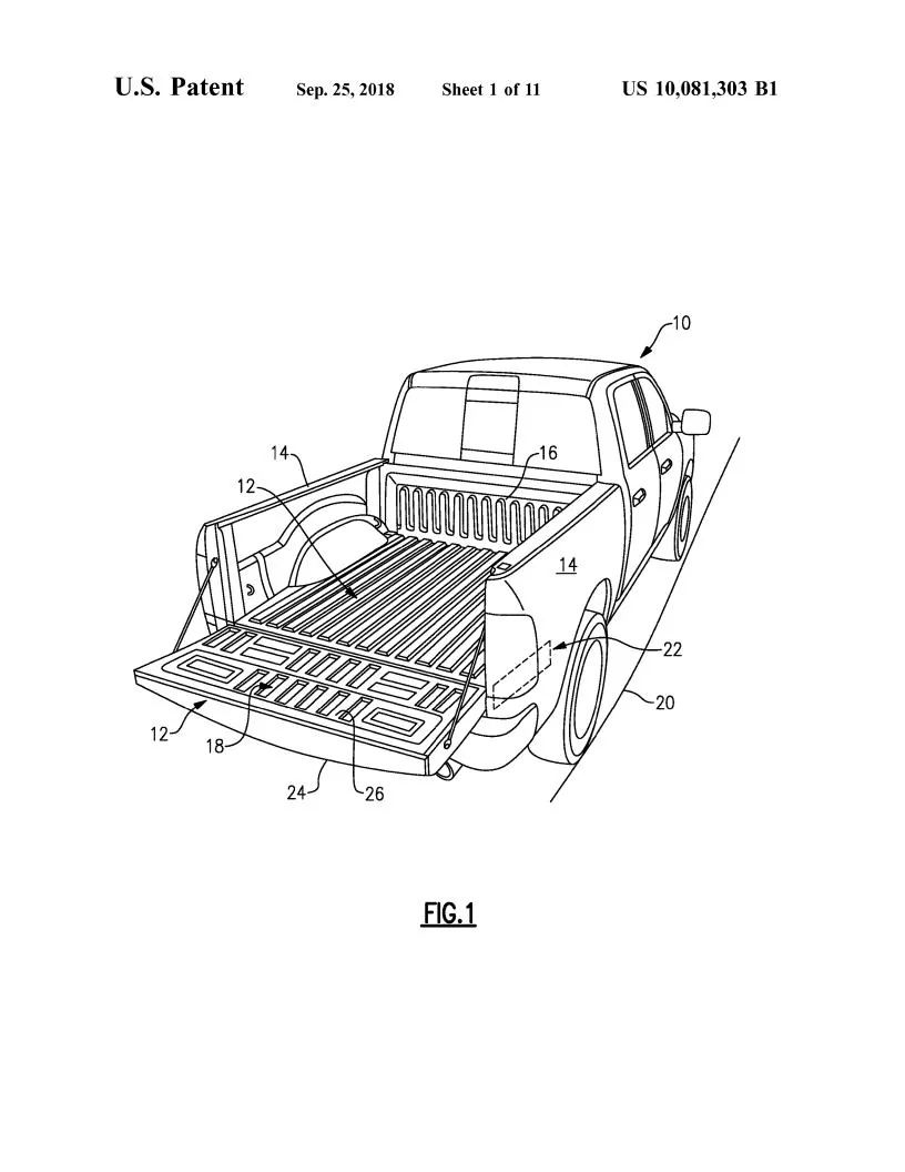

Is #26 in the patent sketch the "step" position? Anyone have link to the USPTO filing? There's probably other sketches that show this better.
MY93SHO
Scott
Apr 11, 2020
Aurora, SD
2018 F150 Lariat, 2012 GoldWing, 1997 Honda Valkyrie Tourer
It looks like #26 is the tailgate in the step position. Is #48 part of the tailgate or part of the mechanism in the bed?
Agree, need more drawings.
