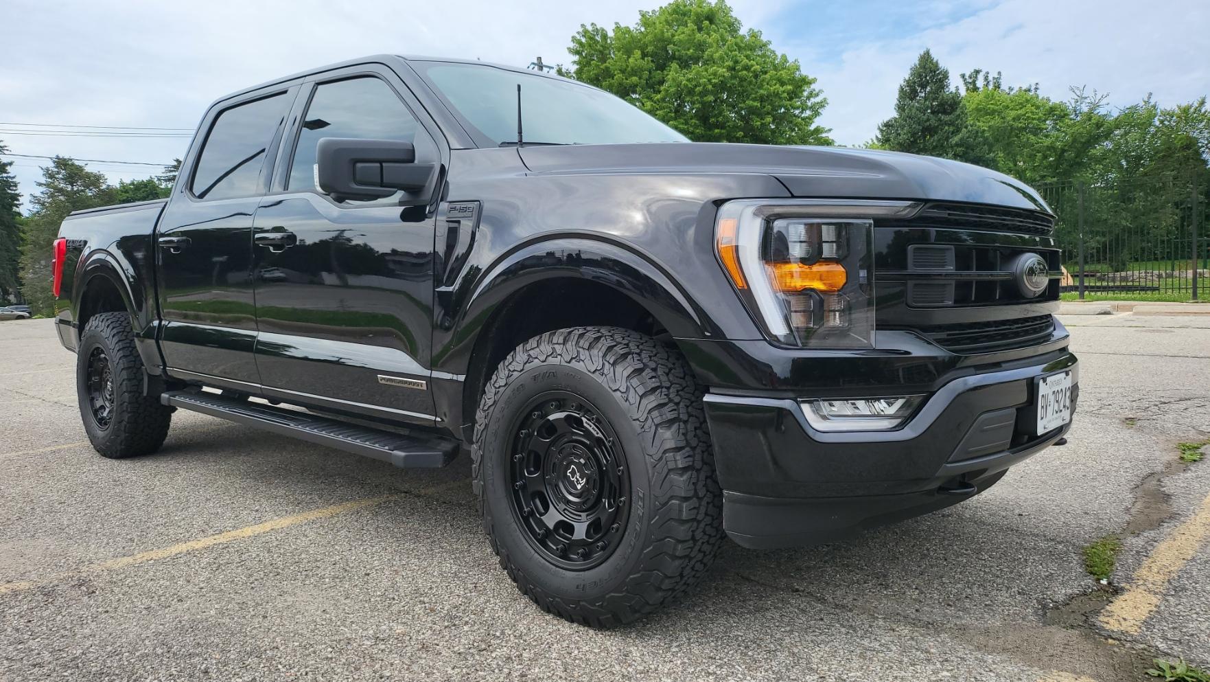

I changed my tires to BFGoodrich KO2 275/70 R18. Also changed the Rims to Black Rhino Atlas 18x9. My Truck came with the Black Appearance Package wheels with Pirelli Scorpion Tires 275/60 R20.
Truck drives great with the new setup. Milage has not really been affected.
