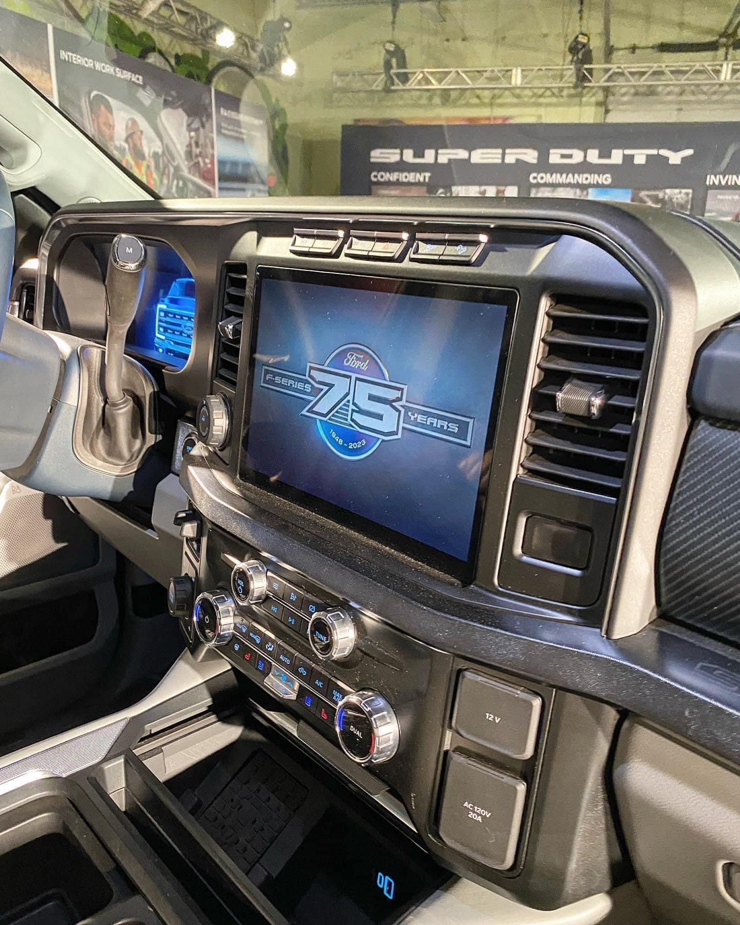

UPDATE: New 75 year splash screen works perfectly on my personal ‘22 Ford F-150 Lariat. However the update doesn’t do anything on my work take-home ‘21 Ford F-150 XLT; seems like it’s still on Sync Version 22192, which needs to be on 22238. Still waiting on the next OTA update or so to get up-to-date.

If you have 22228 you can enable this splash screen as well as the new themes
Did you share the setting for the themes? I can't seem to find any info on it. Or trade secret??️‍♂
I thought the Splash Screen setting controlled this as well, but I just get the "75."
EDIT: thanks for updating in the other thread!
