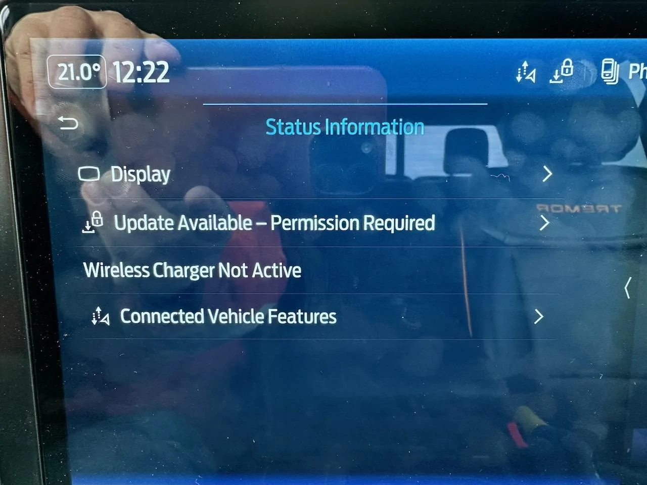

22-PU1010-MIL-QL for me
The reason I asked is that I have a ghost update that needs permission but I can't do anything with it. Did you see a lock in the status bar up top and then perform some action on it?
What do you mean you can't do anything with it? Just schedule a time for it to install, lock the truck and walk away. Come back 15 minutes later and it will be installed. That is update 22-PU1009 or 22-PU1010 or 22-PU1007 depending on what truck you drive.
Mine had the bell on it. Once I parked, I selected it and it told me the update would be completed during my scheduled window, or I could do it immediately. I selected immediately and got my previous screenshot telling me to lock up and get out.
I found this online. There are three icons you can get. A lock is not one of them.
There is a 4th download indicator it doesn't have a bell but a picture of a lock. And that's what I have.
