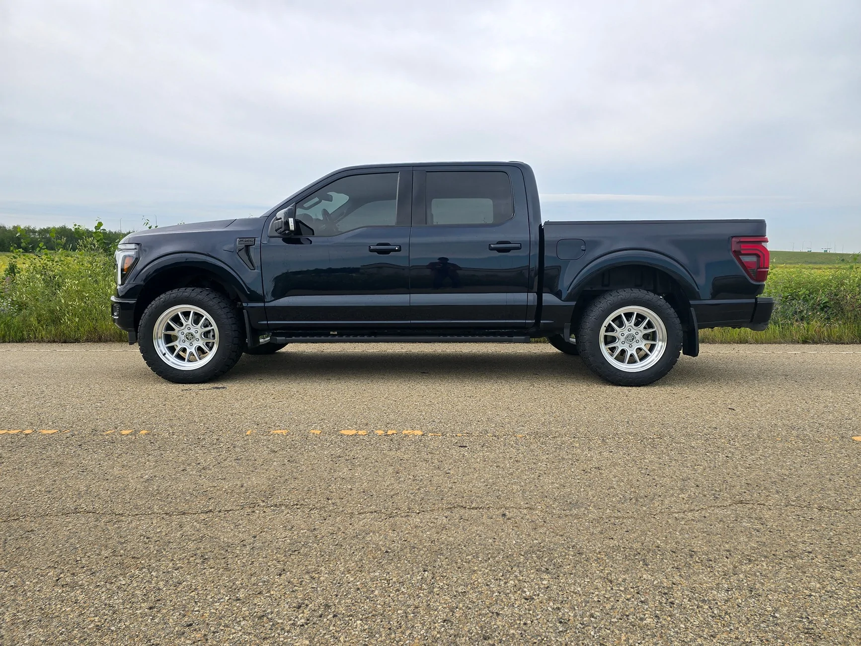

What’s up everyone, just joined the forum. Just bought a 2022 tremor. Beautiful truck But the rake on it is insane. What leveling kit is everyone using. With changing the geometry to much. Thanks

Plenty of options out there but depends on your use case. Some use leveling picks while others use coilovers. Google and the f150 Tremor Forum are probably your best bet here.

If your going to Level your truck spend the money and do it the right way. Buy a good set of coil over struts and Yes you will need new upper control arms to correct the geometry in the front end or over time you will have ball joint problems and alignment issues.
As for the best place for info for your truck. It's right here on this forum. This collective group of owners here are a wealth of information and 99% are always willing to help a member and provide excellent insight. Go over to the suspension forum and ask any questions you want. I bet it's already been asked and answered.

You could use lowering shackles to bring the tail down. Just depends on how you plan to use it and what type of look you prefer.

Coil overs. Fox, Eibach, Falcon, Bilstein, etc make good coil overs.

And if you still want to be able to do truck things, airbags or RAS are a must.
You don't want to have sag towing and hauling.

What specs and have more pics? Looks great!

If you want to get a little more clearance in the front, improve the stance and not break the bank consider the Bilstien 5100 struts they are adjustable up to 2.5”. They use the factory cool spring. These are installed on the strut. I set mine to 2 the second from highest position. This raised my front bumper about 2.75” . It rides level with a moderate load. According to the shop I had install them. This won’t cause any problems with other front end components. I’ve got over 10k miles on after having installed. Cost breakdown. About $500 for front struts and rear shocks. I installed the rear shocks. The labor for the front struts and 4 wheel alignment was $200. I have known this shop for over 25 years and all they do is tire and suspension work.
